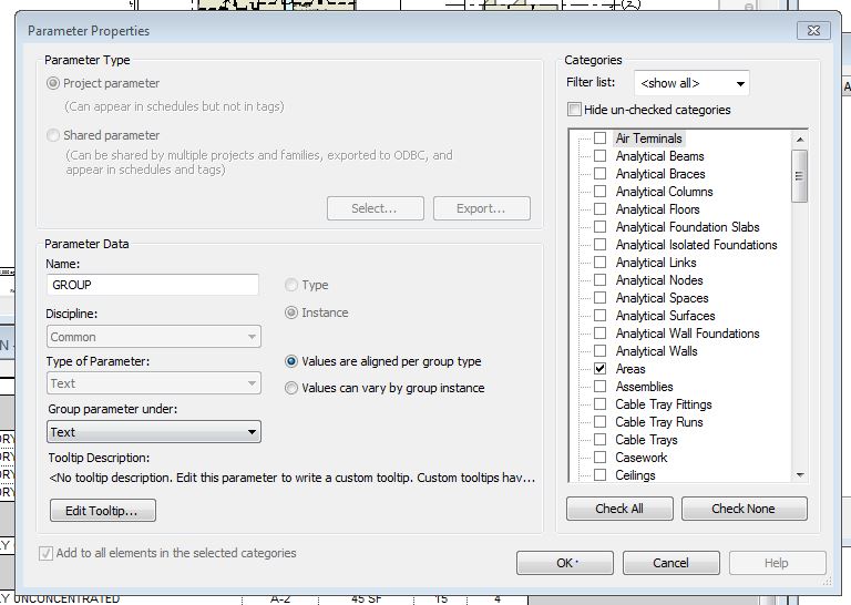

I have a schedule in a hand-me-down file that contains a "Room Style" paramater with a drop down with predefined information -- Accessory Storage, Assembly Unconcentrated, Business, etc.  When selecting information for this parameter the "Group" column autofills with the type of occupancy -- B, A-2, A-3, etc.  However, when two "Room Style" selections are made, nothing autofills in the "Group" column.
I tried to go in and edit the parameters and:
A: Room Style is grayed out/ uneditable.
B. Group is editable, but I can't determine what is tieing it to the Room Style parameter.
C. There are no Shared Parameters loaded.
D.  See the attached screen shots for reference.
Any suggestions on how to get to these parameters and edit their function?

Well I'm still not sure how this was accomplished, but I found a separate (Area Occupancy Key) Schedule that seems to be dictating these autofill columns.
Any furhter input or links on how to achieve this would be appreciated.
