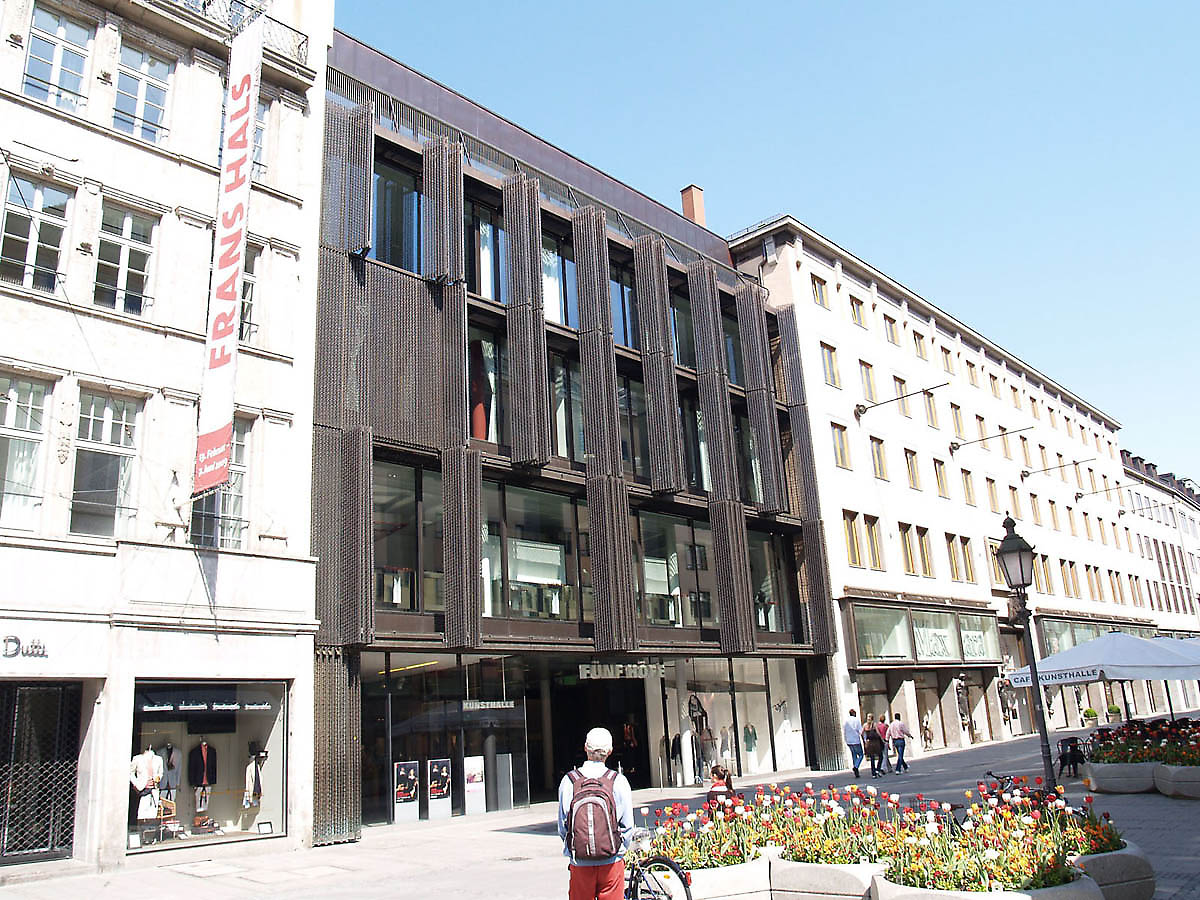

I want to create a double skin facade with and exterior skin made of folding shutters with perforated panels, kinda like Herzog & de Meuron's project Funf Hofe. Any tips on how I could do this? I tried to keep it simple by inserting shutters directly on the wall but it isnt working very well. Please share any tip/idea, I really don't know how to pull this one off.

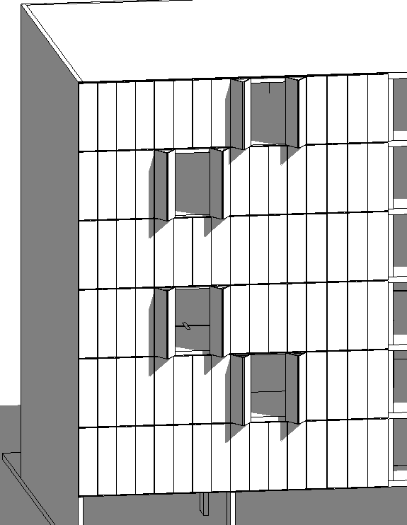

I created a curtain wall with some folding doors i found, any idea how i can represent the perforations?I changed the material of the shutters to another with cut outs but it only shows with render, is there any way I can make it visible without the render?

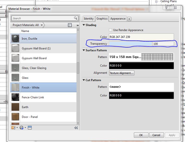

i think you will have to use a model pattern on your material and usee the transparency option in the graphic section - material editor ( as attached )

You should go for the patterns to create the texture.
Do not model those openings in the metal and you will regret. :-)

Thank you, that actually worked! Smile
