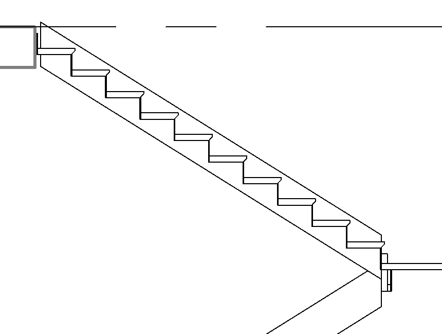

How do I adjust the stringer to reach the top riser and extend past the bottom nose? See picture attached.
I drew the stairs with the run layout and automatic middle landing.
I was able to make some modifications if I edited the stair then the stringer but these are not type changes. I suppose I can edit the sketch but I was hoping to avoid that.

If you hover your mouse over the stringer and hit tab once, you can select it separately from the stair itself. You then have further constraint options to adjust it. With it selected and clicking edit in propoerties you have further options about its size. Alternatively, if you hover your mouse over the stair treads, you can select them and choose in properties to end with a riser ( or not). Try these two options, they may help. Smile
