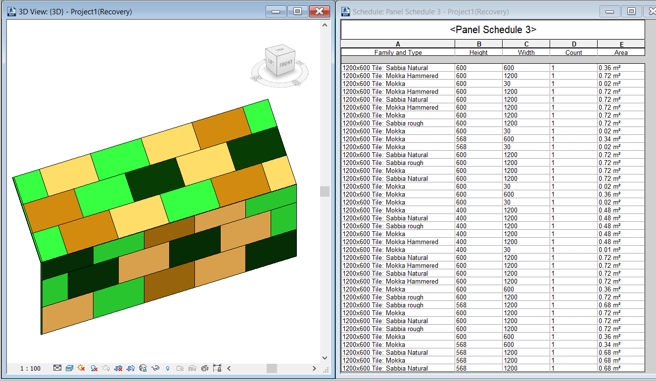

I want to create and schedule a large sized bulding stone cladding. I was trying to see how it works for the complex areas.
But facing some problems here.
The vertical stone cladding wall showed in the picture was created by using a thin wall 20mm think  and using create parts i divided it to look like seperate pieces.
For the slant wall, i created a line using mass and extruded that like a sheet, Then using wall by face i created the slant wall. And divided it like i did for the vertical wall.
The problem is when i schedule, the slanted wall dimensions are not generated in the scheduling.
Please find the attachments.
And give your suggesions
Thanks.

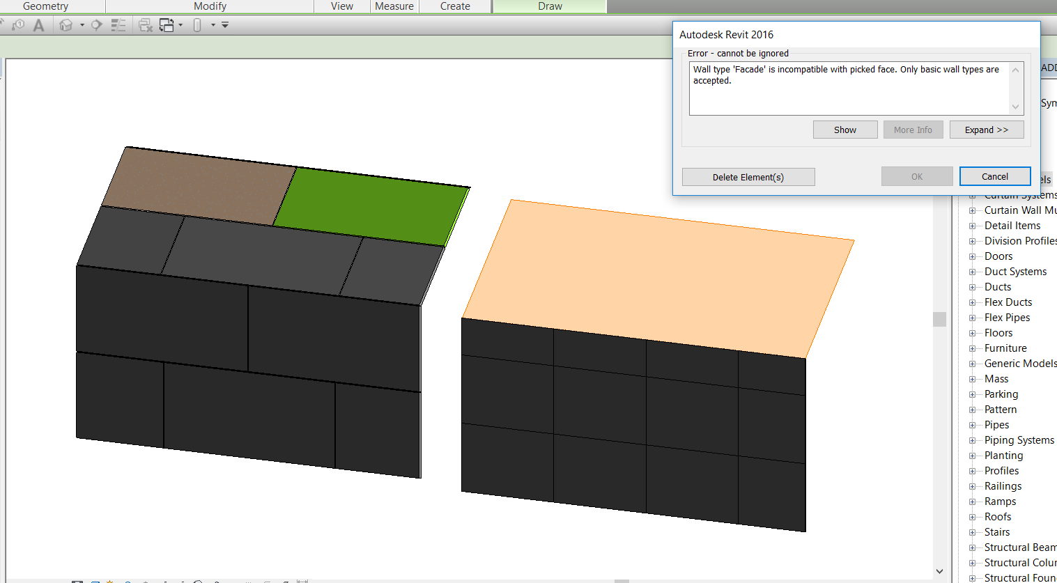

i have used another approach with the cladding also as i used curtain wall and i was setting the panel as the type of wall i need and the mullion as a void or the grouting material , and it worked very well for me

Thanks @ Elnazer2.
I tried that way  but revit does not allow me to create on slant face.
It gives me an error as you can see in the attachment.

Thanks to WWHub & Elnazer2.
At last i found the solution.
Elnazer2, I used curtain panels as you mentioned.
Those steps were taking time but i got the result as i expected.
Once again thank you guys for your support.

am glad you did and just to clear this out for the others , for the non vertical planes you can use curtain system from architecture tab
