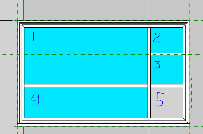

Hi I'm Peter and quite new to Revit, so far been using it for about 1,5 months and I have a question.

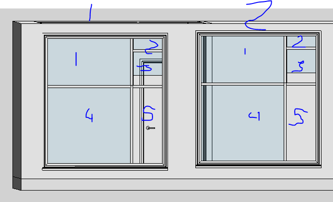

I'm trying to tag each window pannel with a unique something as seen in image 1 within the family, then in the main project you'd be able to better target a spesific glass pannel as seen in image 2. This data should also be able to be exported and the family should be reusable/resizable.
The only sollution i've been able to come up with is by simply giving each glass pannel a different glass material like Glass1 Glass2 Glass3 etc, this however doesn't seem like the best way to go.
Does anyone have a good sollution for this?

Individual components are not taggable but nested, shared families are.  Do your research there.
