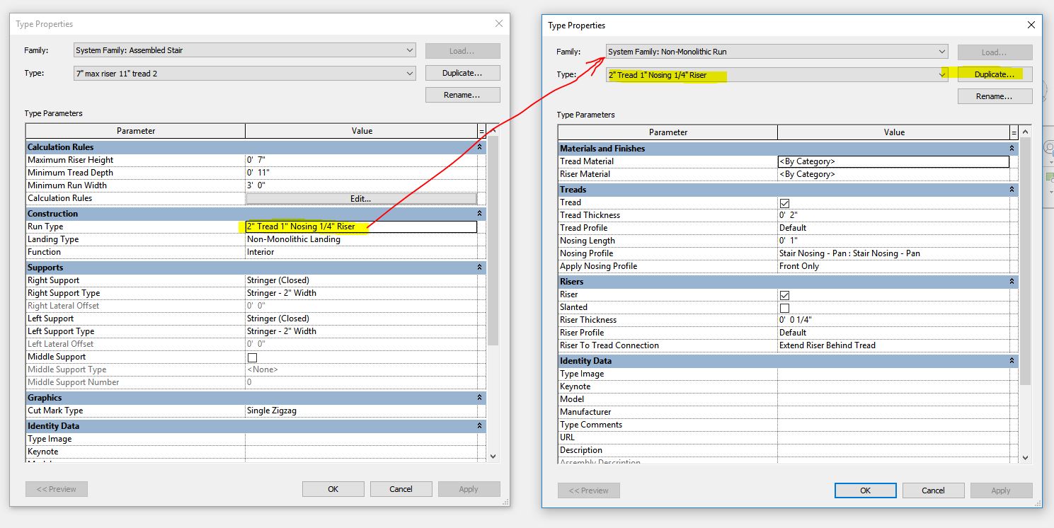

How can I make two stairs with different materials. When I duplicate a stair and give it new materials, the materials also change in the original stair.

Even though you duplicated the stair, they’re both still using the same Run Type, so in addition to duplicating the stair, you still need to duplicate the Run Type.

Hey
is it that simple, my class thanks you very much.
