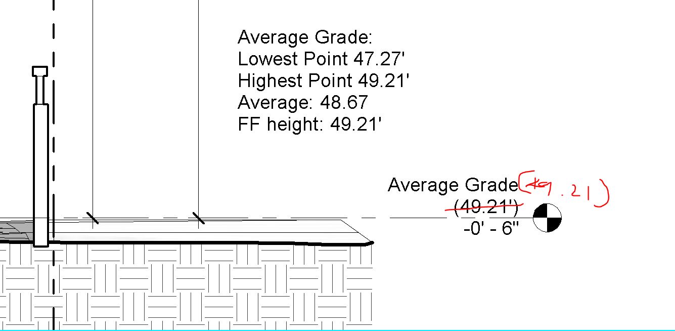

How do I get the elevation bullet to NOT stack the text. so the picture has only two lines of text, name of level, and below that the height.
I want to add some info, but it starts to stack the text. see pic.

if i understood you right you need to have all the data on the same line , so you need to extend the label in the level head family used in the type
