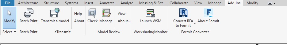

Fri, Aug 25, 2017 at 2:09:34 AM | Revit 2018
Jamie351
Jamie351 Avatar
Joined: Mon, May 23, 2011
124 Posts
4 Stars: 7 Votes
How do I uninstall the add ons....
It lags for no reason even on a smaller job. Now I have upgraded to 2018 kind of stuck with it..
I had it installed on my HDD not SSD so I have just reinstalled it on SSD no difference.
Here are the current add ons I have installed (I havent installed any myself)
Revit 2018........
Mon, Aug 28, 2017 at 3:18:25 PM | Revit 2018
blue442
blue442 Avatar
Joined: Tue, Aug 25, 2009
0 Posts
5 Stars: 1 Votes
Autodesk got in contact with me.  They said the "P&ID Modeler for Revit 2018" and "Structural Precast for Revit 2018" were throwing lots of errors.  I unistalled both.
You can do that by going to add/remove programs and search for "Precast" and "P&ID"  If they appear in the list, you can click uninstall.
