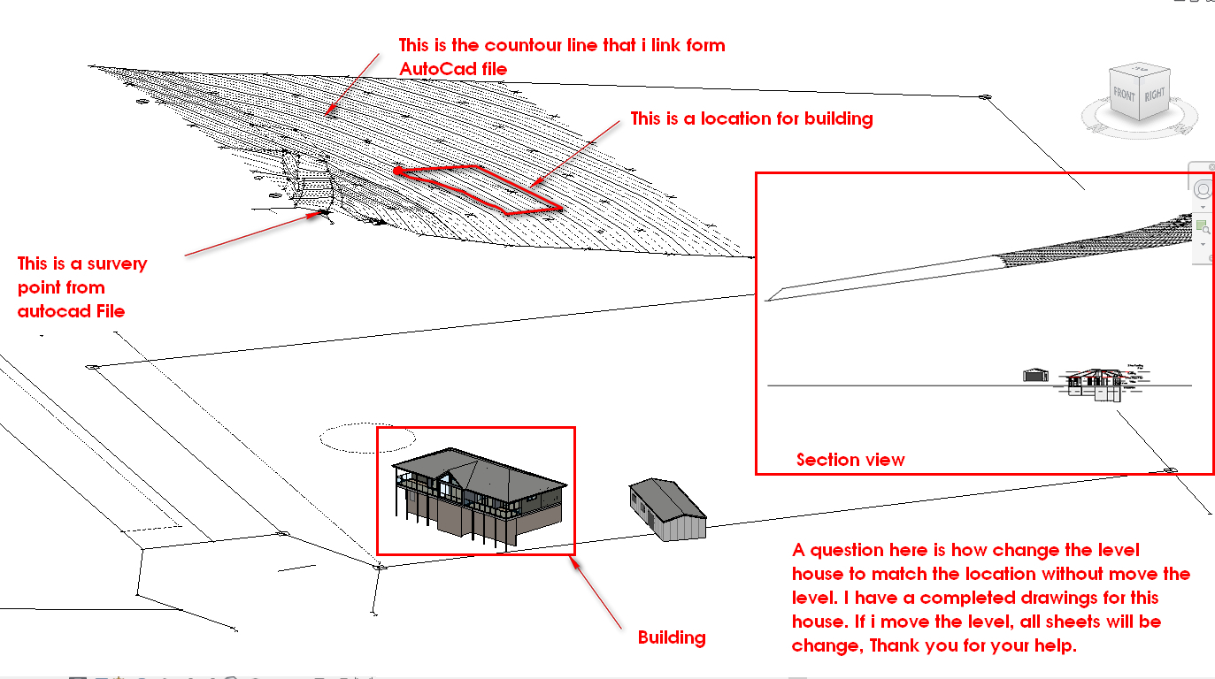

Hi,
Good day,
I am a newbie for this. I have a issue for this case, please give me a hand.
I show my problems in the image below.
Thank you,
Regards

So which is at the right level? The house or the contours?If the contours are corrrect then you need change the level heights in your house to bring it up to sit at the correct height.If the house is correct then just select the toposurface and lower it down until the levels are at the correct height.
