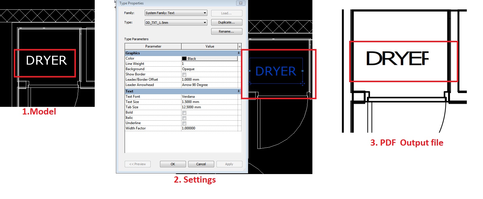

I get a cut in the end of the text note. I tried changing all the settings. But nothing worked.
Can anyone please help me out.
Please see the attachement for better understanding.

It appears that your PDF writer may be substituting a different font.  Try a different one like 'cute', it is free on-line.

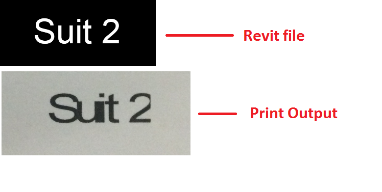

But even in the printing output it is coming same as the PDF output! (Please see the attachment)
I used Ariel font style for Dimensions & Text notes.
The problem is only with text notes.
I tried changing text style but result still remains same.
Note : I printed directly from revit.

First possibility - You don't say what Revit issue and what updates you have installed.  There are occasional bugs that are fixed with updates.
Second possibility is your printer driver and PDF driver.
What you show in your image has never come up as a problem with anyone else so that leads me to believe it is your system.
