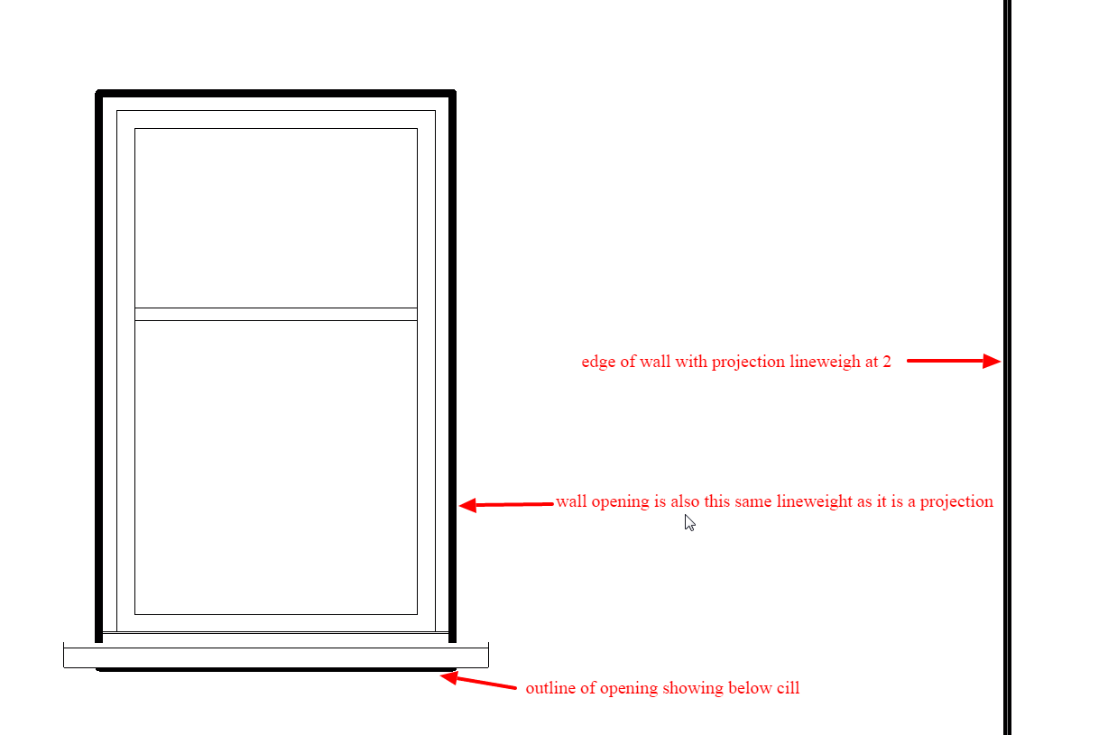

This has been wrecking my head of late. I have set my walls to a certain line weight in projection. Is there any way to change the lineweight around an opening. Changing the wall projection lineweight changes opening also, but I dont want them to both change. Its hard to explain but when the line weight is at a thicker weight, you can see the line below the cill of the opening. (see image). I have tried hiding the line in the family but to no avail. Anyone have a work around?

Try Manage Tab - Settings Section - Object Styles - Model Objects - Walls.Check the Walls Category Row against the Line Weight Projection & Cut Column.If not this, check visibility settings for that view.If not this, check if you have a view template applied..If not this, check if you have any over-ride settings applied to the view.
