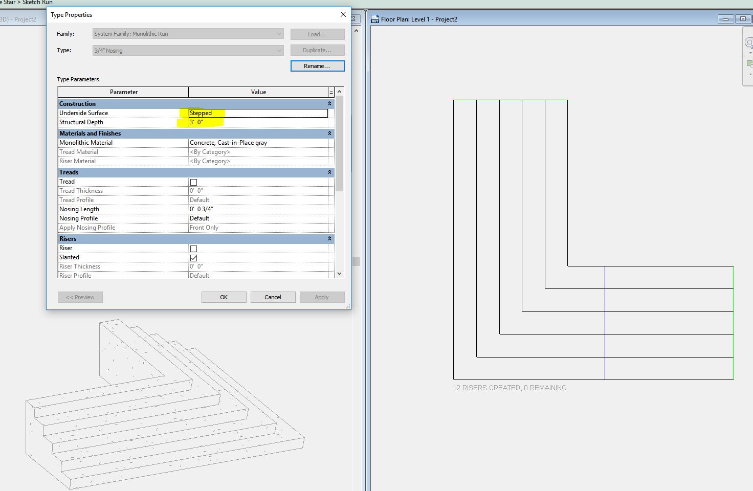

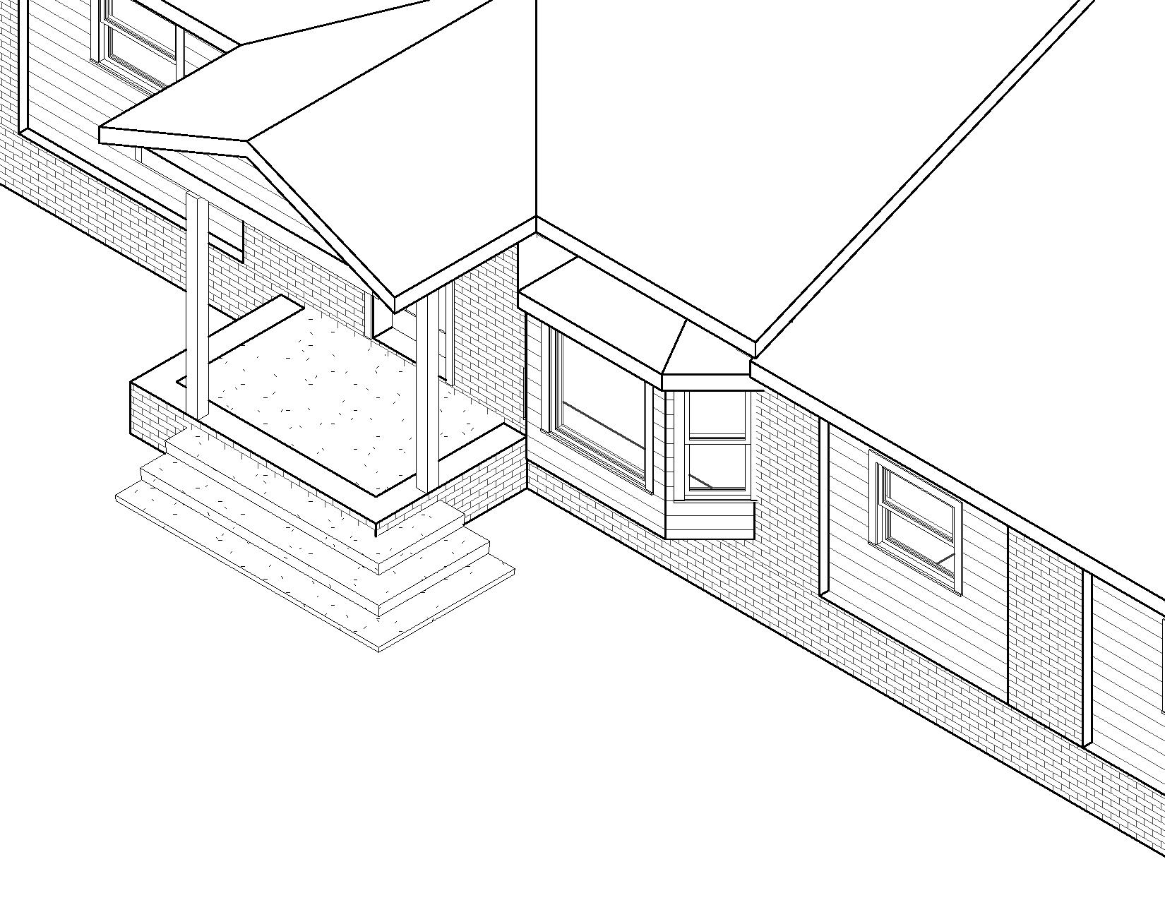

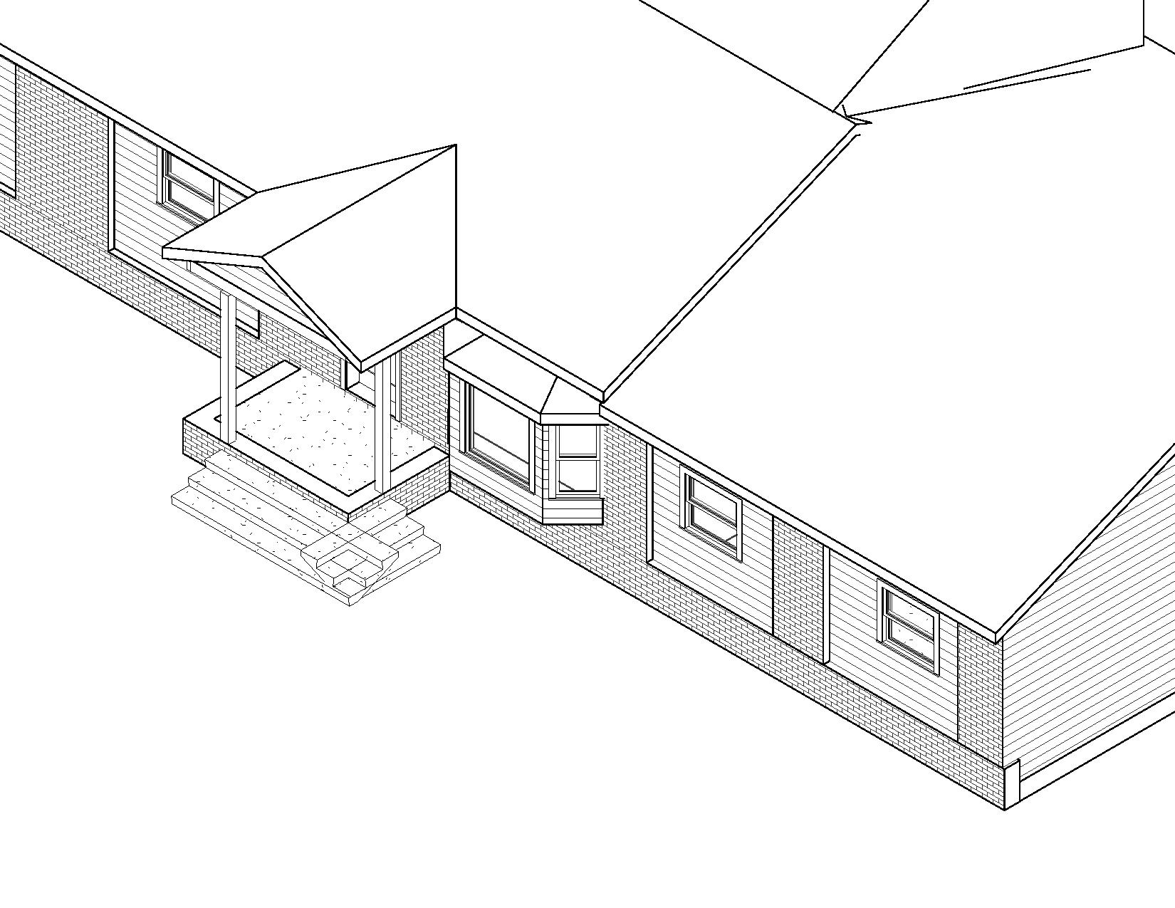

Does anyone know how to make these stairs come to a common point/
I use 2013
Thanks,
Gary
Mon, Apr 17, 2017 at 9:58:50 PM | convert stairs
pijpiwo
pijpiwo Avatar
Joined: Fri, Sep 3, 2010
0 Posts
5 Stars: 25 Votes
Convert component stair to sketch, draw desired shape, use stepped underside surface and give 2, 3 feet for structural depth.

Thanks!
Along with this and a utube video, it works great!

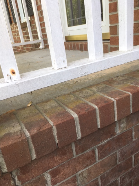

Don't you think the best design is that your porch slab sits on your brick walls.... actually extending over them slightly to create a drip?
Tue, Apr 18, 2017 at 8:36:29 AM | convert stairs
GLKIRK
Joined: Wed, Apr 10, 2013
2 Posts
Actually, here in VA, we use, what we call a "Rowlock" around the porch/stoop peremiter like this photo.
And/but I did not draw that.
I wanted to be clear in showing that the cantilever in the beams, because of where the columns are, did not pass code.
Thanks!
Tue, Apr 18, 2017 at 8:47:28 AM | convert stairs
Here, that detail doesn't work.   Because water gets between the brick and the slab, freezes and expands blowing out the brick.
I just didn't like how the steps met the wall.  The rowlock would help except when I see that detail down there, typically there is a brick pier at the ends of the step and the concrete steps flow into the concrete stoop.  You never step on the brick.
