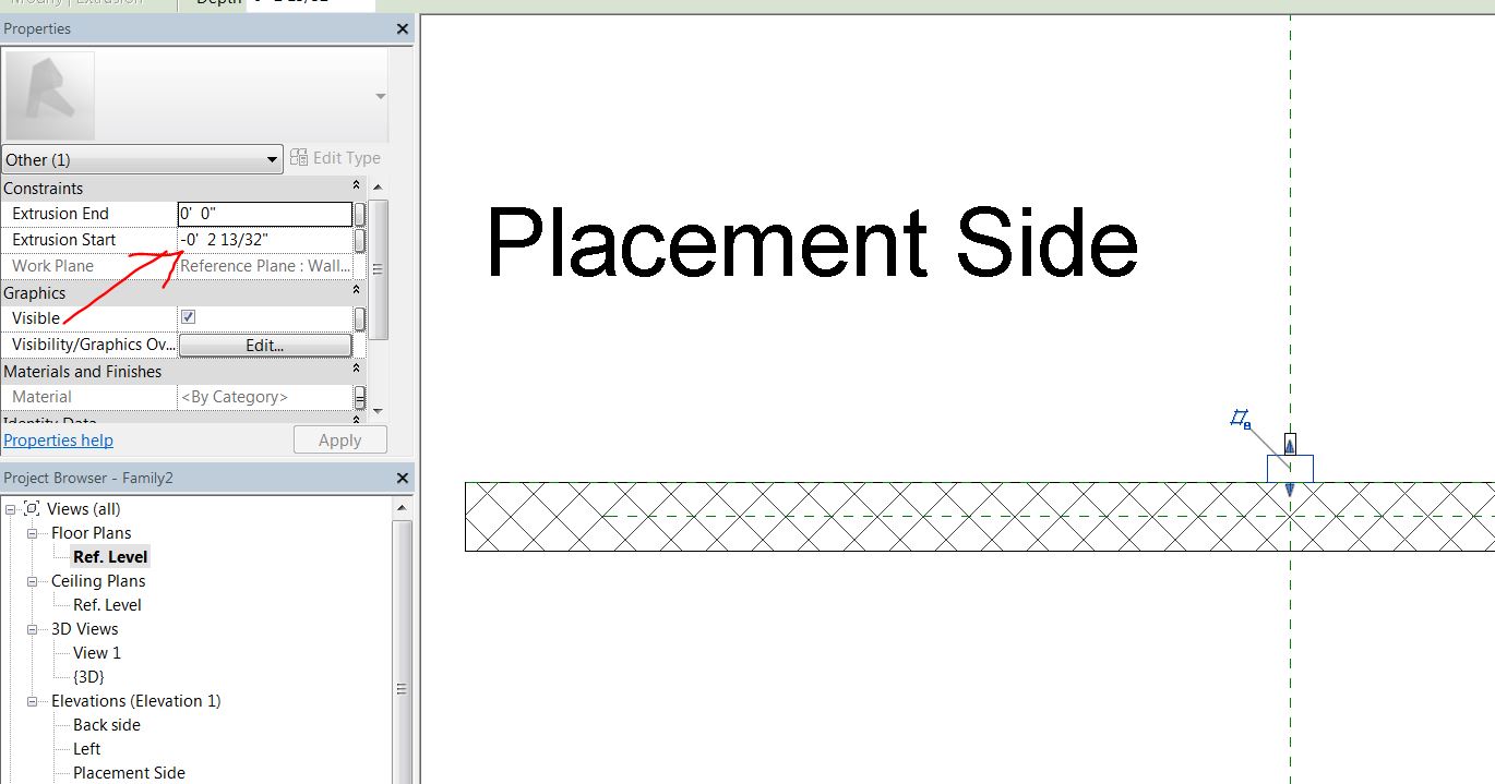

Why is my models showing negative extrusion, instead of positive? its on the placement side, so am I missing something?
Mon, Apr 10, 2017 at 4:04:37 PM | negative extrusion
It is the way you created your extrusion.   If you edited these numbers so the extrusion start was 0 (The work plane surface) and edited the end to be - 2 13/32, you would have the smae extrusion.   + & - are just directions.

Oh. duh. LOL thanks. the  start and end are reversed. I didn't even realize. Not enough coffee I think!
