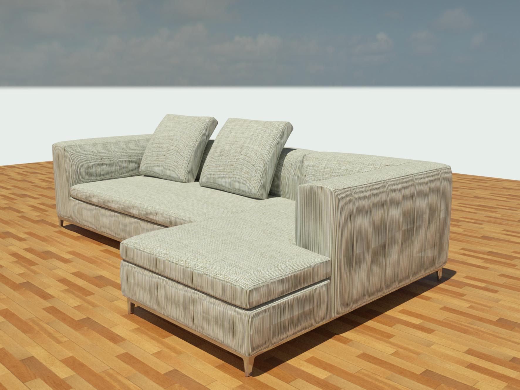

Hi everyone!
Has anyone solved how to improve horrible automatic texture mapping of imported models built with mesh?
(V-ray for Revit, has improved the texture mapping?)

The picture attached shows finely the problem.
I say that is a pity, because I'm quite satisfied of new Revit's render quality.

It seems I figured it out!
Since Revit allows to import Rhinoceros files, I converted the mesh model to NURBS with Rhinoceros, than I saved the file to .3dm extention.
Voilà!
Importing a NURBS object automatically convert the Rhino's layer(s) in material(s), directly uploaded in the Revit material library (generically, named Material 1/2/3/n).
This seems to fit the texture very well with each face of the 3D object.
Hope this could help.
