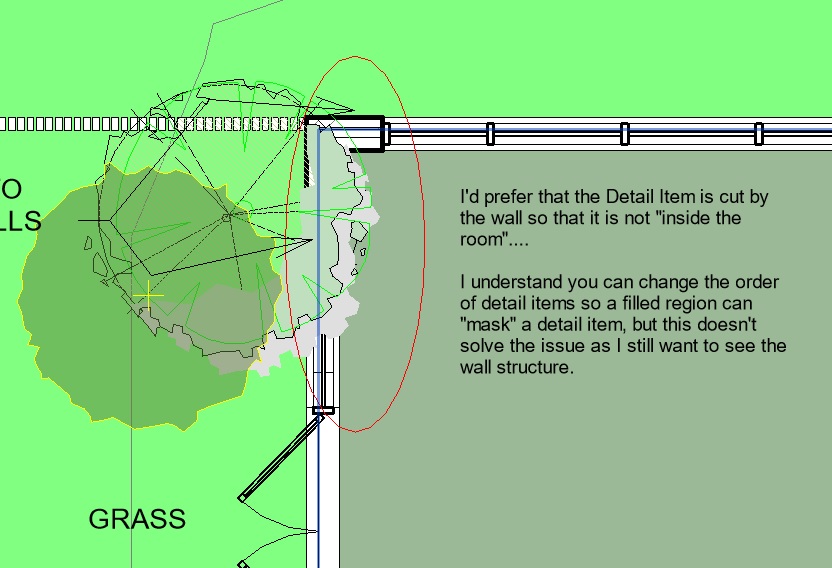

I had a question for the Revit gods. I am using Detail Items to show landscaping. The problem is that when a detail item is placed close to a wall, the detail item does not stop at the wall and I end up with the parts of the tree (for example) inside the building.
See attached image. I have tried a couple of different approaches using a filled region to mask the area and then changing the order, but this doesn't really work.
Any thoughts on how to stop this?

Sorry - detail items are 2D and they lay overtop of all model elements.  You need a different process.
