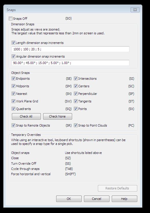

Hi everyone!
When I'm trying to draw a line (LI) that ends very close to another, the snap automatically hooks the second to the first. Well, how could I change this operating range of the snaps?
This happens when the two lines start from the same origin.
To be clear, I need snaps, so I can't disable them (SO, Tab).
Thanks

Tab key disables completely the snap. That's not what I'm looking for, actually.

Find the attachement.
Make sure these default settings are same and try again !
Tue, Mar 14, 2017 at 7:39:37 AM | One question about snaps
The tab key will allow you to pick which endpoint you want.
