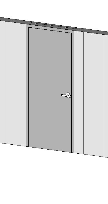

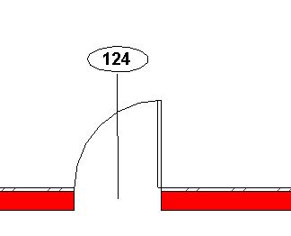

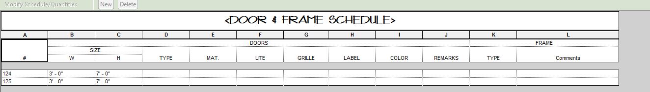

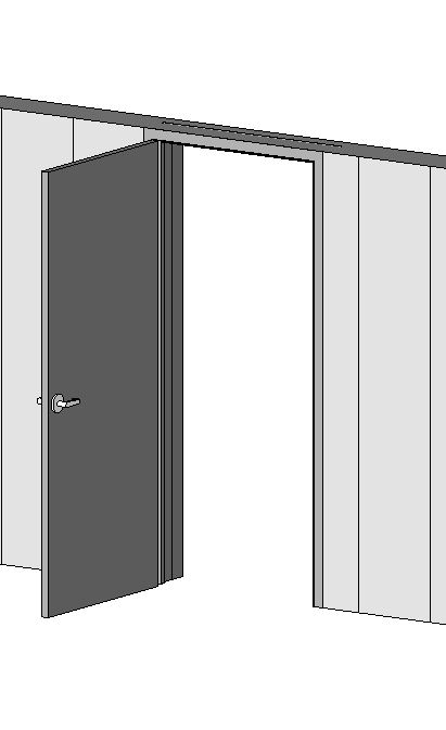

I have a door family that I created that has a door leaf family inserted into which can change to have a half lite, full lite etc.  I have 2 copies of this leaf in the family so that I can have an option to show the door closed or open in 3D becasuse we do walkthroughs.  My problem is when I add a tag to the door it schedules it twice and I'm assuming it's because I have 2 leafs in the family.  Is there a way around it?

After doing some research myself it appears its scheduling the nested family because it's under the door family and I should switch it to generic however I have a lot of different families and I would rather not gp back through and spend all the time changing the family category and reloading into the family and back into the template.  Is there any way around this?

It sounds like you did the leafs as doors and they are a shared family.  Why?  The door should be the host family and that you want to schedule.  The shared parameter you use to control your leaf you may want to schedule but really no reason to schedule the leaf.

Any nested family in the door frame families (which populate the door schedule), has to be created from generic template.
The only way to work around it is do followings:
1. Move one door tag out a little bit, then you will see two tags at one door.
2. Keep the door tag for the door frame (which populate the door schedule), and rename it as the way you want to be shown in the door schedule, such as A101.
3. Rename the other to J101 (as Junk), hide it in the view. Some of our old door families even populated three or four door tags. The problem is you don't know which door tag is the right one, or you can just ignore it, which I don't like.
4. Then, you will get a door schedule with two groups of doors, one started with A and the other J. Split the schedule to two, move the Junk one out off the sheet. Then you have to do the whole thing in each project.
Here is what I did: (I did it several years ago, might not exact).
1. created a new nested family with the same name as for the door leaf from the generic family template.
2. Copy and paste the old door leaf into that new generic family.
3. Re-load it into the door frame family and click the "overwrite". Then you will get the clean one.
