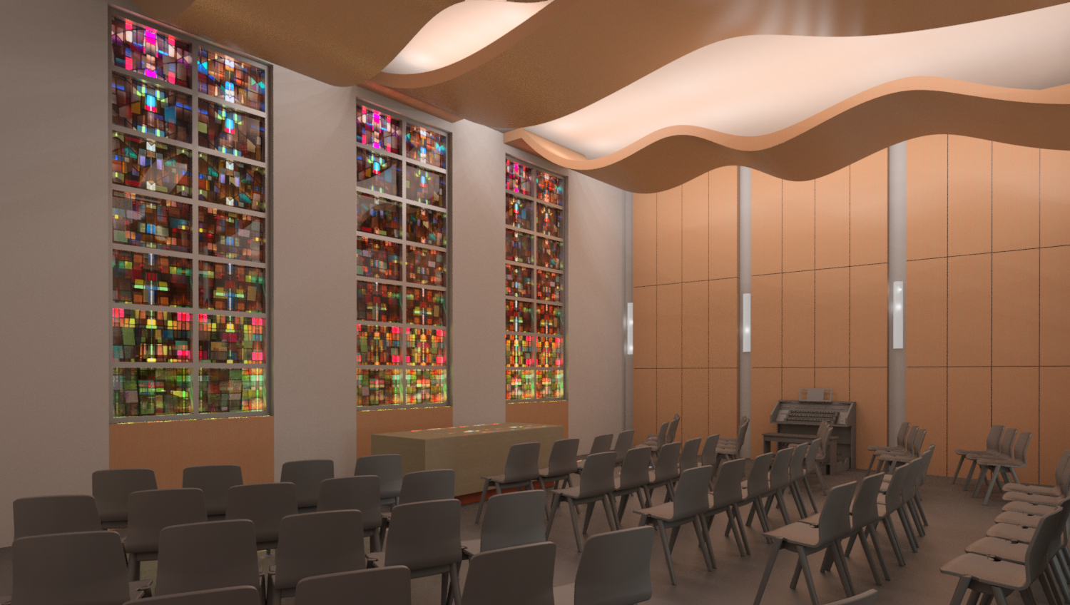

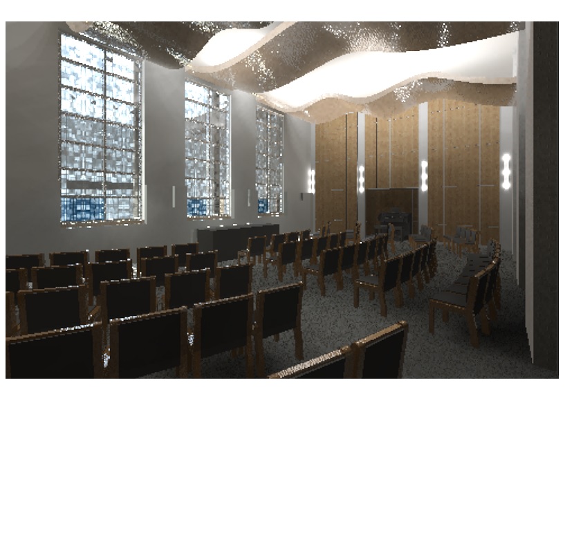

Tue, Feb 28, 2017 at 11:55:47 AM | Revit 2015 Revit is NOT rendering the image color correctly, it renders it GRAY
minsky
Joined: Fri, Oct 17, 2008
19 Posts
1 Stars: 1 Votes
OH, I understand alright.
the first image is what it used to look like.
the second is what it looks like now.
Tue, Feb 28, 2017 at 1:22:01 PM | Revit 2015 Revit is NOT rendering the image color correctly, it renders it GRAY
What you want / was done/ was not done with a material.  This was either a decal or was added with photoshop.
Read again the post I linked.  It suggested one full pain of glass for the entire window to host the decal.  A decal has to be fully hosted and you don't want to mess with 14 decals, just one.   The muttons can be modeled in place or a CW in the same place with empty panels.
