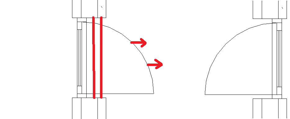

Hi Revicity users,
I hope someone can help me with this problem.
I want to fix my door family so that the door frame wont change position when I flip the door.
For example I want the dimension between the inner wall and the door frame to be 60 cm - fixed, so the dimension between outer wall and door frame can be variable.
See the attached jpgs - the red lines symbolize that I want the frame to stay in the same place no matter if I flip or not, and the dimension (60cm) between inner wall and door frame always to be 60cm. So basically only the door swing needs to flip, I guess?
Hope someone can be of help :-)
Thanks.
///Nicky

You can create a parameter "Set-Back" as an instance parameter.
Unfortunately, you have to manuly change each of them.

Hi CDWdavid,
Sorry for my late reply.
Just wanted to say thanks for your input.
I found a solution by just using symbolic lines and adding a visibility parameter to each. So now I can just switch either interior or exterior door swing on/off - which is a simple fix.
