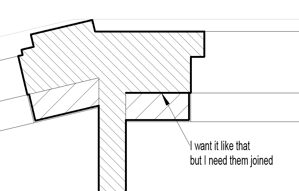

Hi.
There's such issue:
I override walls' layers so that structure layer has the thicker line but when two diffirent structure walls joins the line between them becomes "common edge" and i want them to have thicker boundaries.
Pictures explains everything, I think.
P.S.
The "use function" override isn't satisfying ;P
Any idea?
Thu, Feb 23, 2017 at 10:25:40 AM | Joined walls - lineweight
Sorry - that will not happen.   You can use the linework tool.
