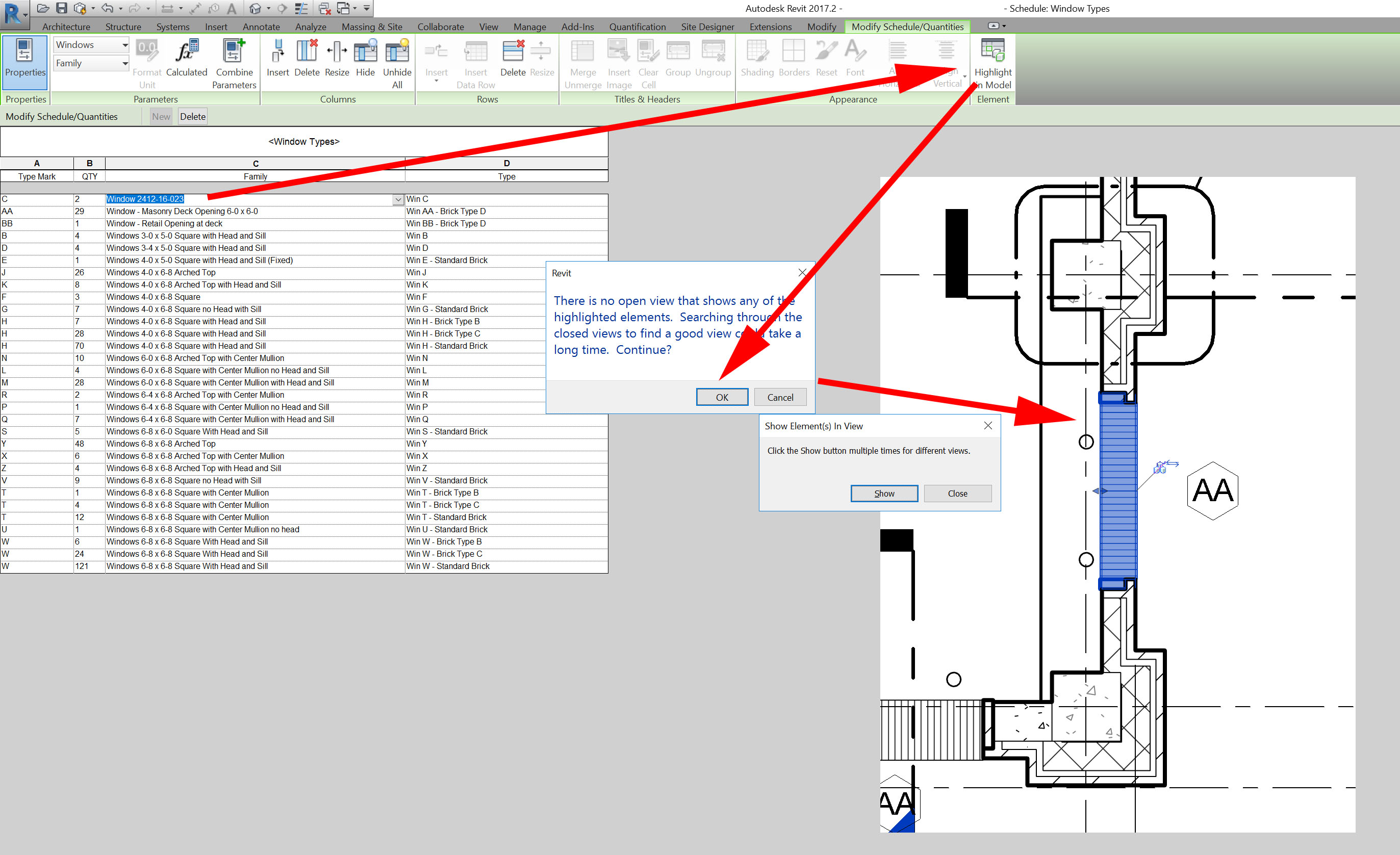

I am tring to make a window schedule. and there is a window somewhere in my project that shows up on the schedule, but I can't find it anywhere in the project. I want to delete it. I can select it in the window schedule, I cant delete it, and when I try to switch windows, it de-selects it. So its just sitting in my project. unselectable and cant be found. I tried to make the window like 50' long, just to see it change in the 3d wireframe, no luck.

Make sure all worksets are on in a 3D view and do a zoom E.  Now open your schedule up sisde by side with your 3D, select the window and look for the icon in the 3D.

you were right. a couple windows were marked as new, not existing to be demolished, so yeah. Shoulda thought of that. thanks for that.

Additionally, you should be able to click on the window in the schedule then hit the "Highlight In Model" button.  That should bring you to a view that can see the window - even if not opened.

Oh man, that is exactly what I needed. Thanks!
