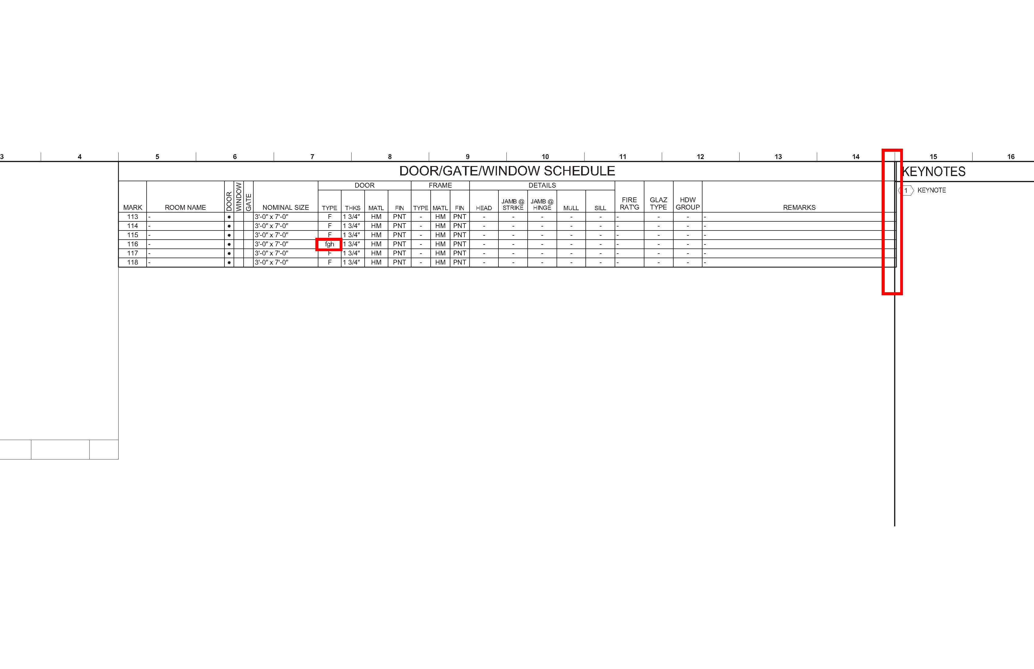

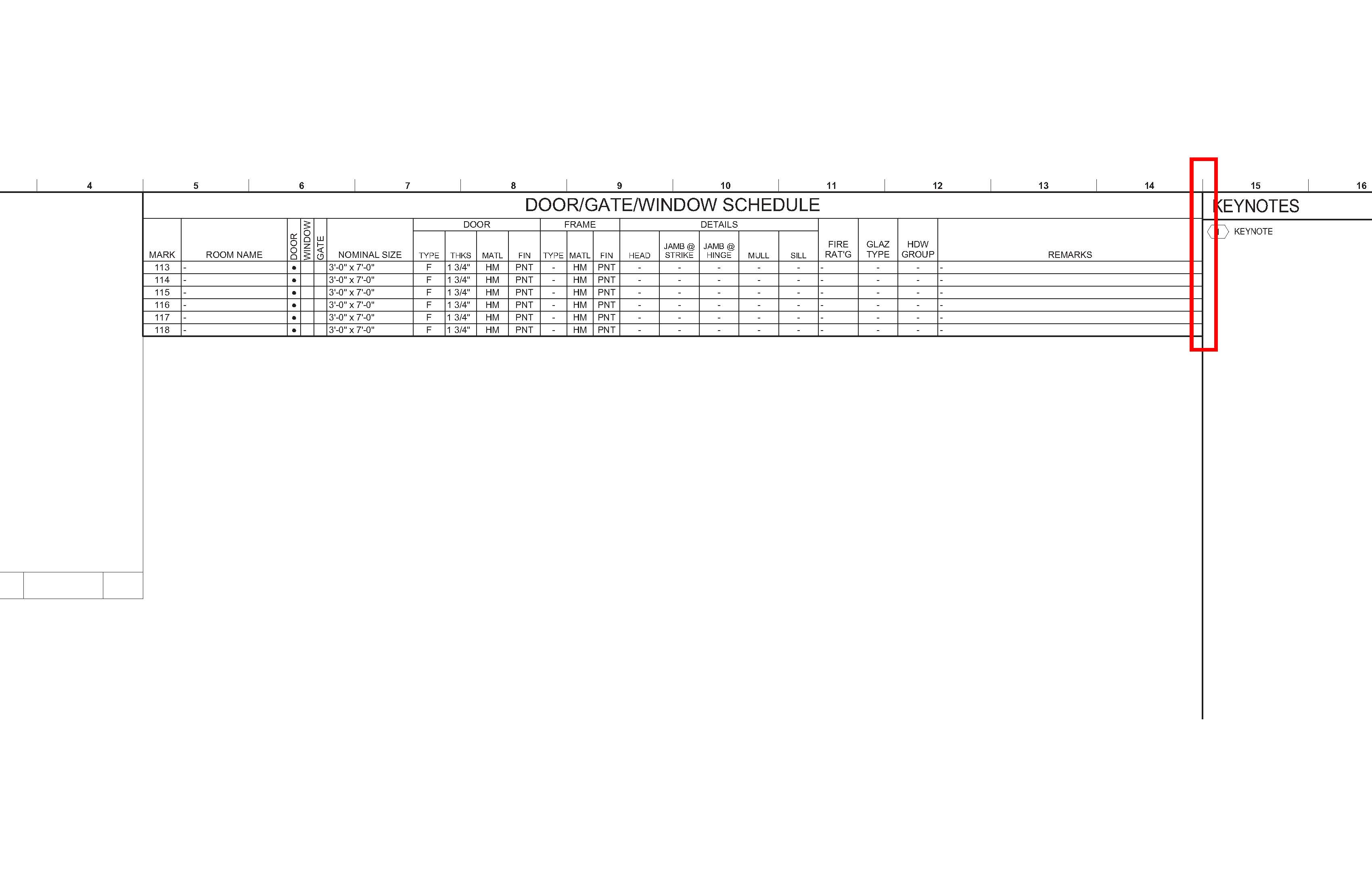

Hi WWHub,
Please see the attached prints.
The Project3 has the correct alignment, while I was modifiing the Door Type for Door 116, accidentally dragged the cell line and changed the column width from 0.6" to 0.623", see attached Project3-2, the alignment changed.
I worked on Revit 2015.

This is not entirely true. It used to be that way, but they changed that some versions ago (I think in 14 or 15). Now, the column sizes between sheet and schedule views are tied together.
@ David, I don’t think there is any good way to lock the column widths. You can pin the schedule on the sheet - that at least prevent messing with the schedule on the sheet, but unfortunately doesn’t have any effect on the schedule view.

I tried both ways and of no avail. The column width on sheet still changed when the actual schedule changed.
It should be an item on the "wishlist".
