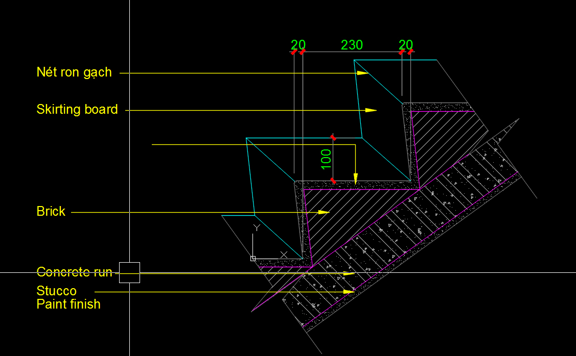

The image attacked is the details I need make by revit. But I can't find the way to do this.
Anybody know how?
P/s: I mean draw this detail by "real" modeling objects. Not just a 2D detail imported from autocad...
Sorry about my English.
Wed, Feb 15, 2017 at 11:34:40 AM | Stair step detail
There is no way to do this with the stair tool.
Why do you feel a nead to model rather than detailing?

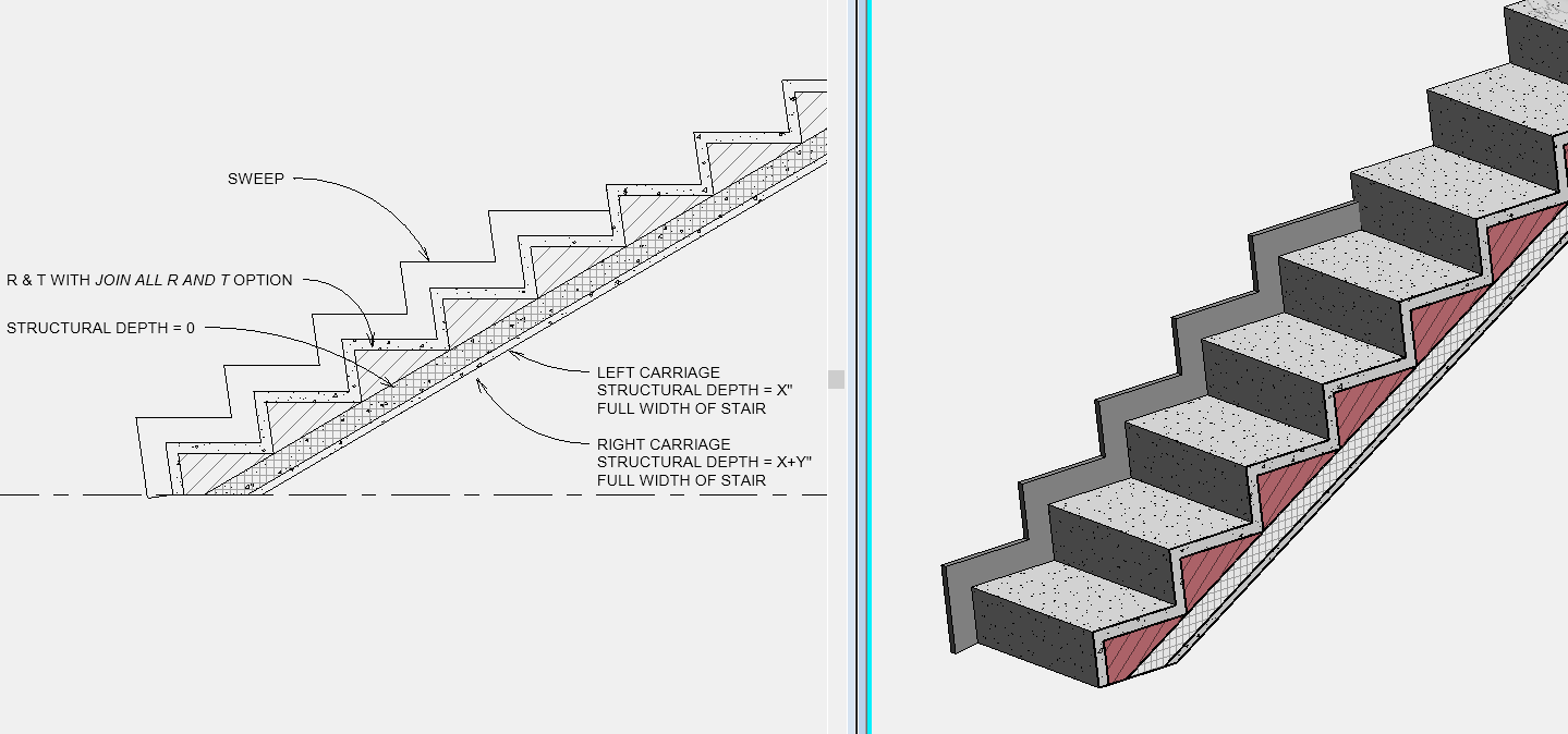

If it really needs to be modeled (vs detailing) and If you don’t mind a very minor hacking…
Wed, Feb 15, 2017 at 4:55:11 PM | Stair step detail
That's some hacking - good job.

Thanks for your help. But I think too complicated to make a classic architecture detail. Imagine, what happend when you need adjust your staircase when you follow that way?
I imagined about revit is a software help me solved all trouble in my job. But not, hopeless.
This case just a small case make me confused about revit.
Anyway, thanks for your help.
