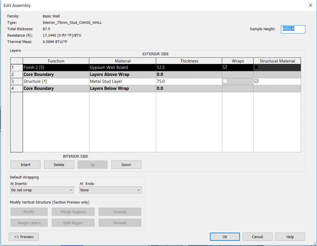

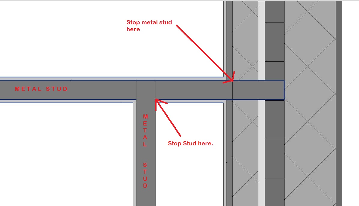

Hello guys,
I am trying to make a proper joint in the intersection area. But it does not resulting as expected.
Please help me out. And find out the details in the attached pictures.
Thank you

Read up on: wall layer wrapping:https://knowledge.autodesk.com/support/revit-products/learn-explore/caas/CloudHelp/cloudhelp/2015/ENU/Revit-Model/files/GUID-69B6DC75-56A9-4F35-BE24-80048360E2BB-htm.html
Wall join cleanup:https://knowledge.autodesk.com/support/revit-products/learn-explore/caas/CloudHelp/cloudhelp/2015/ENU/Revit-Model/files/GUID-130A65BC-8C57-4C31-8C07-F96041771539-htm.htmlWall Core Boundary
