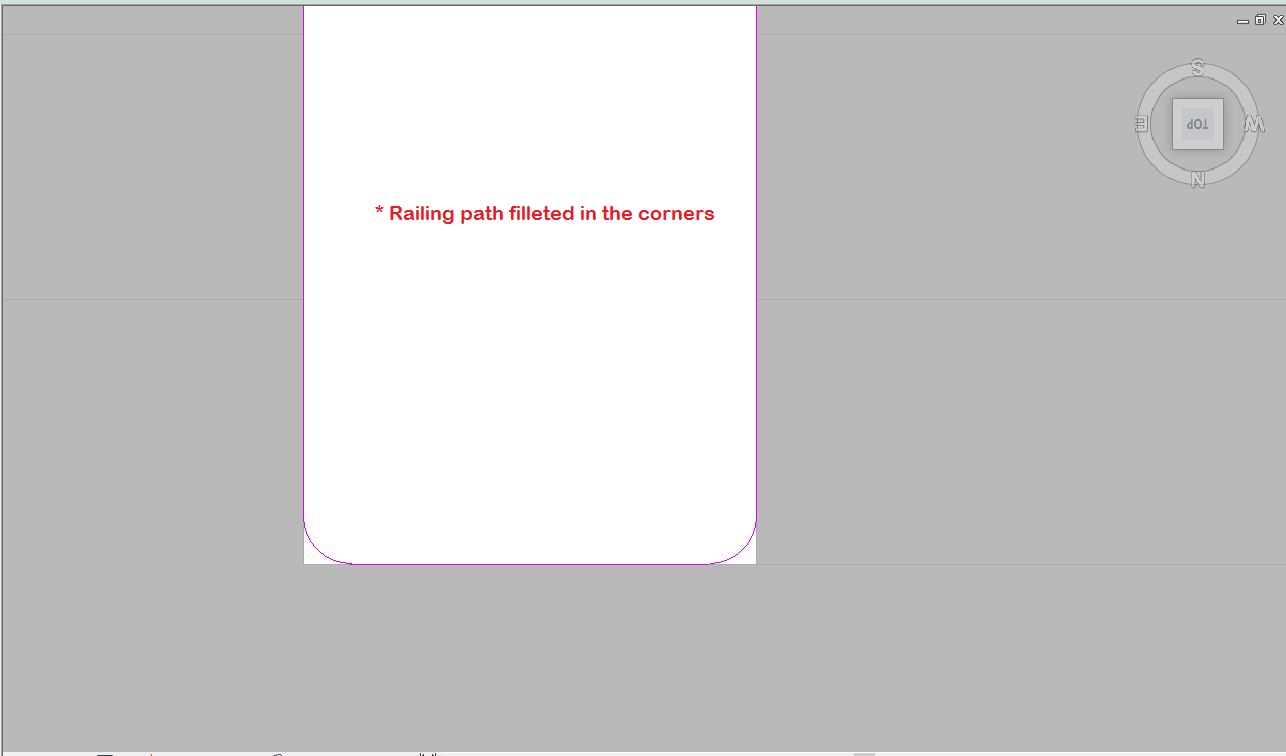

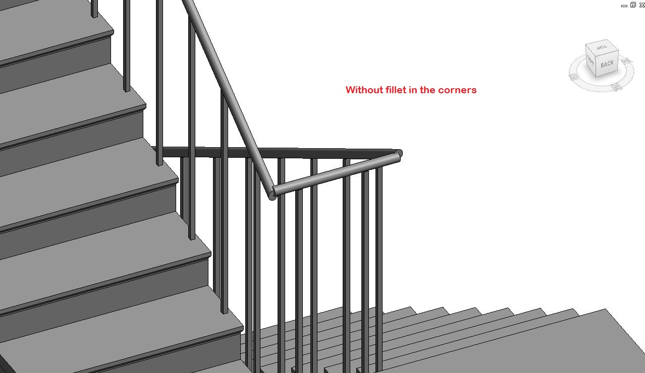

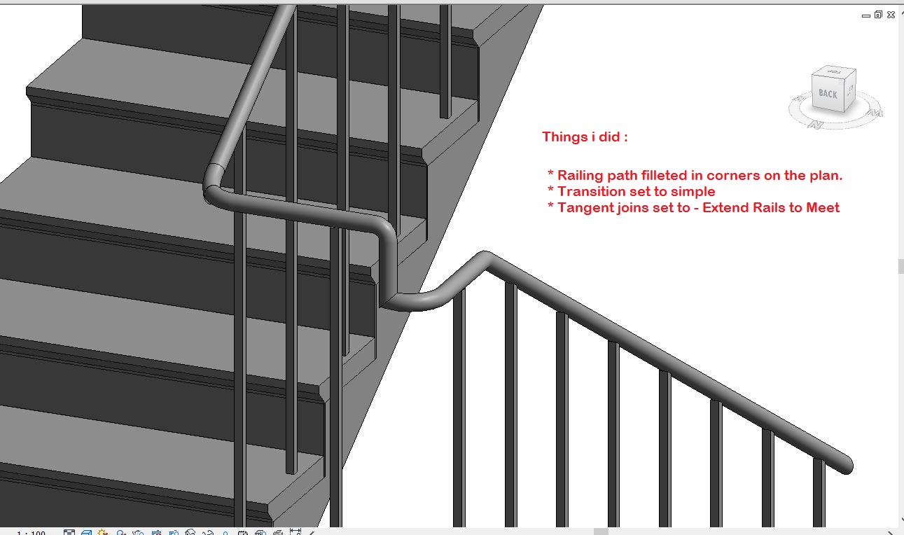

Hello guys,
I would like to have a smooth and simple transition in the internal corner of stair rail.
But i end up with weird results.
Please have a look at these attached images.
And suggest me a solutions.
Thanks
Fri, Feb 3, 2017 at 10:01:41 AM | Railing corner issue
Why are you filleting the railing path?  That is really strange.  If you want a more round transition, you will have to break the railing and add your own components I think.
Where you didn't use the curve, your problem is the railing needs to be to meet you height requirements for landing and stair.  You can map out where that junction is based on your risers and the angles.   Try sliding the railing back onto the landing so the railing joins correctly on the left.  This may cause you to have a flat on the right because of your last riser location.

Thanks to WWHub & blue442.
Later i erased the top rail and created one using sweep.

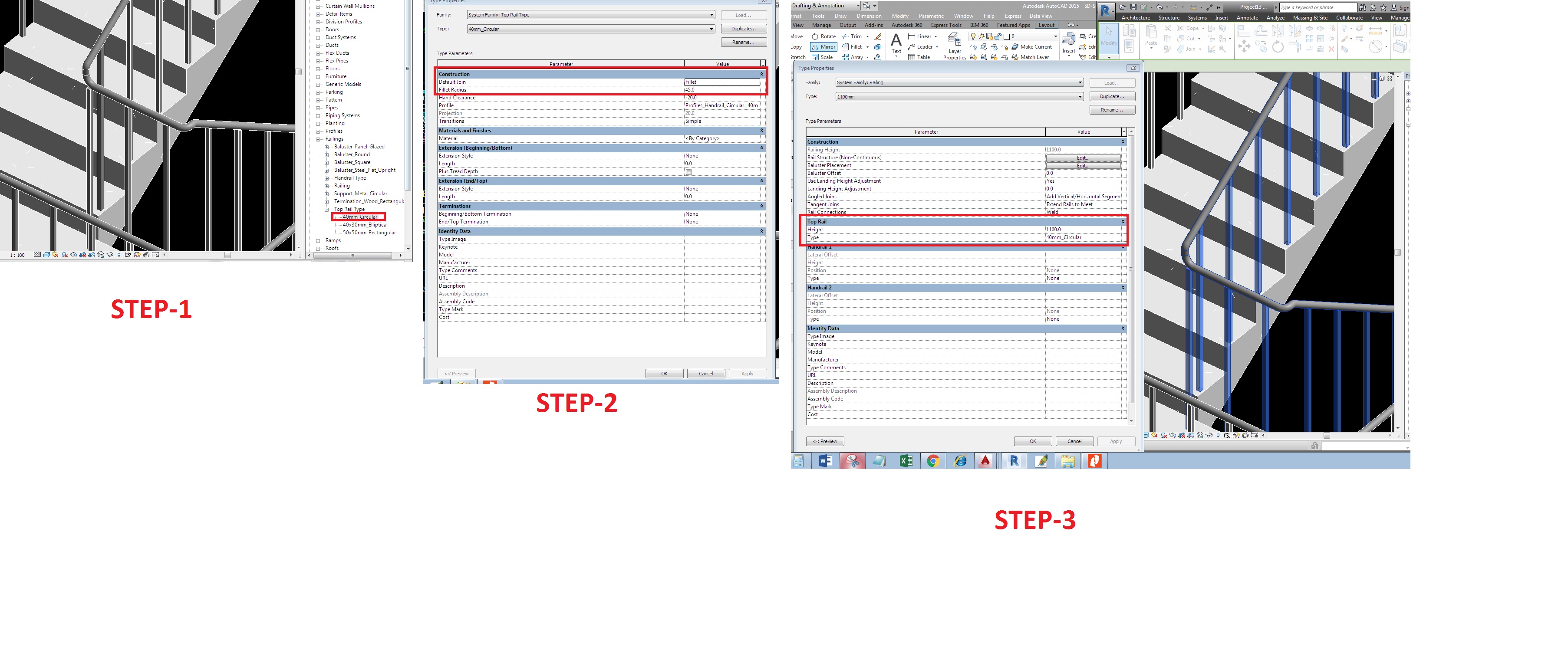

Hello all,
I found out the way to create smooth corner in revit railing.
The steps are :
1. set default joint to fillet in type properties & set radius bigger than the top rail diameter.(Project browser>Families>Railing>Top rail type>Right click on 40mm Circular (Default one) & Choose Type properties )
2. Change top rail to 40mm circular in railing properties.
I really liked the result & it saves lot of time.
Thanks for your support _/\_
