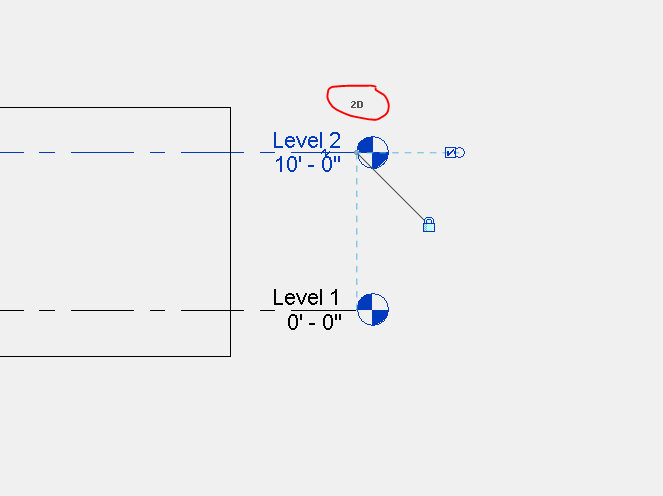

Is there a way to make it so that elevations on oposite sides of the building do not have the same lenght of level lines extension.  If you change the extension length of an elevation line(s) on the south side of the the building, then the North side reflects that same length change (same with east to west).  Is there a way to unlink them so I can have the legths on oposite elevations be different?

Levels will behave like this in 3D extends. Either, manually click on 3D to change to 2D, or adjust the size of the crop region so it cuts the levels. They will switch automatically to 2D.
