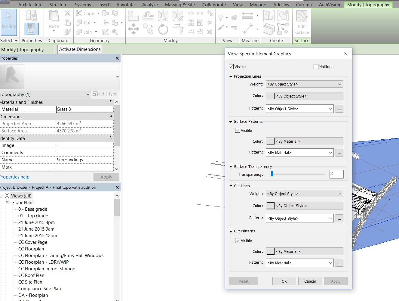

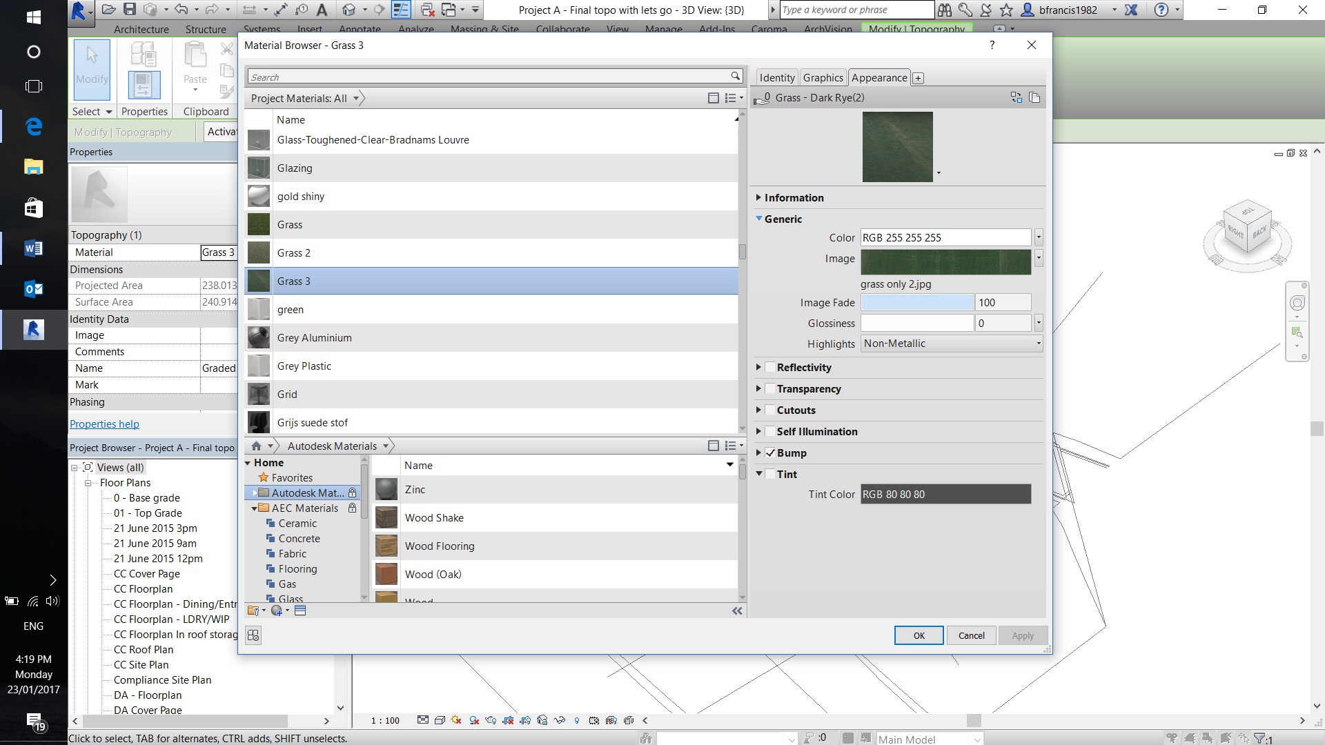

(revit 2015) I originally had no issues with this but changed computers (making sure all my objects and images reamined in the same file destinations when transferred). however now when i view in realistic or render my site the topography remains grey, even though i have assigned a material (see screenshot). I have checked my VG settings and there are no overrides in place to prevent viewing the grassed surface so am a bit lost.

Those are your render settings, what does your graphics tab say?
Also, phases?

i have a graded site region and an existing (2 diff phases) but they are both coming up grey my topo graphics tab is attached

Go back and look at your original image..... What kind of color do you think 255/255/255 gives you then look at the graphics tab in that first image.   You need a color and you need a fill pattern (probhably solid fill).
