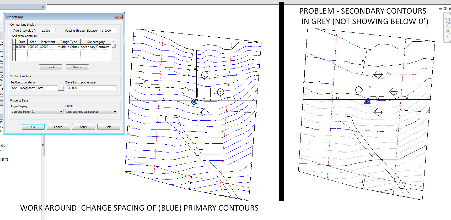

I am also having this problem and I have never had it before, it seems like a 2017 glitch.  I drew my topo plan myself and the file is empty (no imports, etc.), I just started the drawing to see how much of a slope we are dealing with on site.
In my case it was primary and secondary contour lines that would show up above the 0' line, and strangely ONLY the (blue) primary contour lines showed up below the 0'.
WORK AROUND:  I changed the spacing of my (blue) primary contour lines closer together (to the spacing of the secondary contour lines).  This worked for me.   I can no longer can differentiate between primary and secondary contours, but it is better than nothing.  At least I have contours all the way down the slope, including beyond the 0' level where the house is.

Thu, Apr 12, 2018 at 10:01:59 AM | Revit 2017 - Topography contour lines visibility
rozicki
Joined: Wed, Jun 3, 2015
0 Posts
5 Stars: 2 Votes
Sorry, see attached image.  I couldn't delete the image in my original post.
