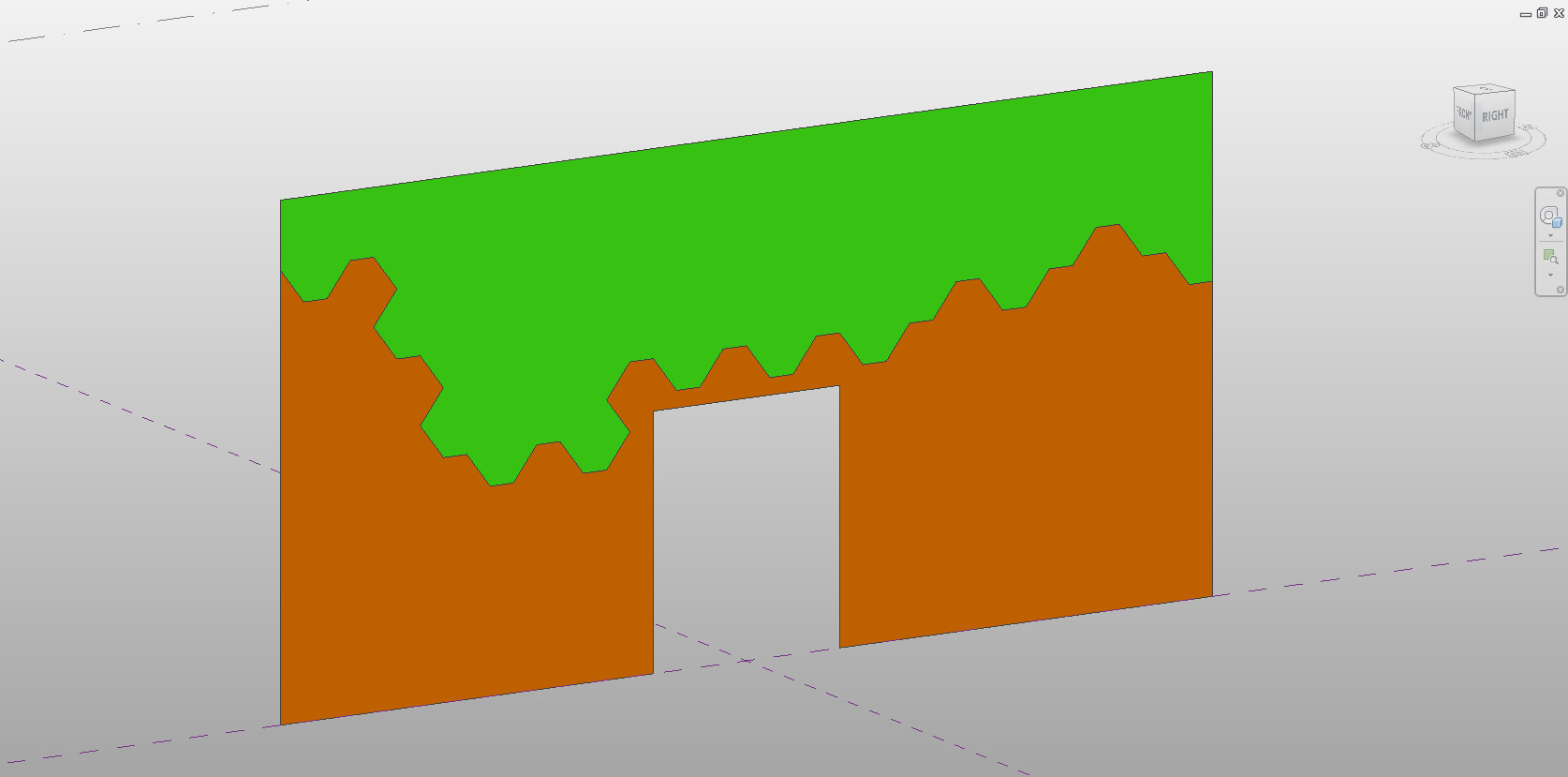

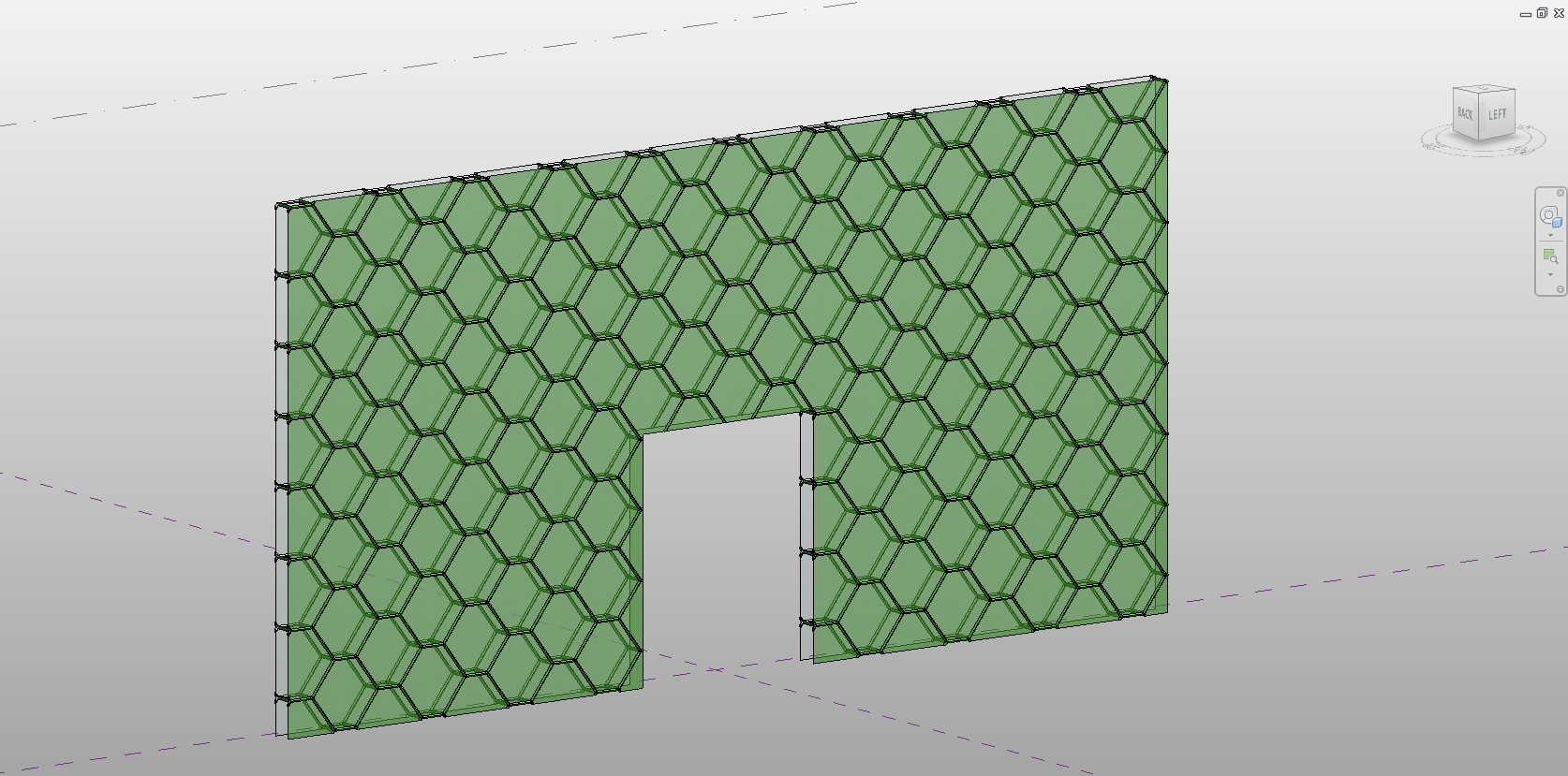

I created a hexagonal wall pattern in the conceptual massing place with the help of the Metric Generic Model Pattern Based family. It is a curtainwall with a steel mesh front of the curtain wall. Both pattern of the curtainwall and the mesh is identical (please see the attached snaps).
What I would like to do is to colour the mesh with 2 different colours front of the curtainwall so that I could draw a dividing line which follows the pattern.
How can I do that?

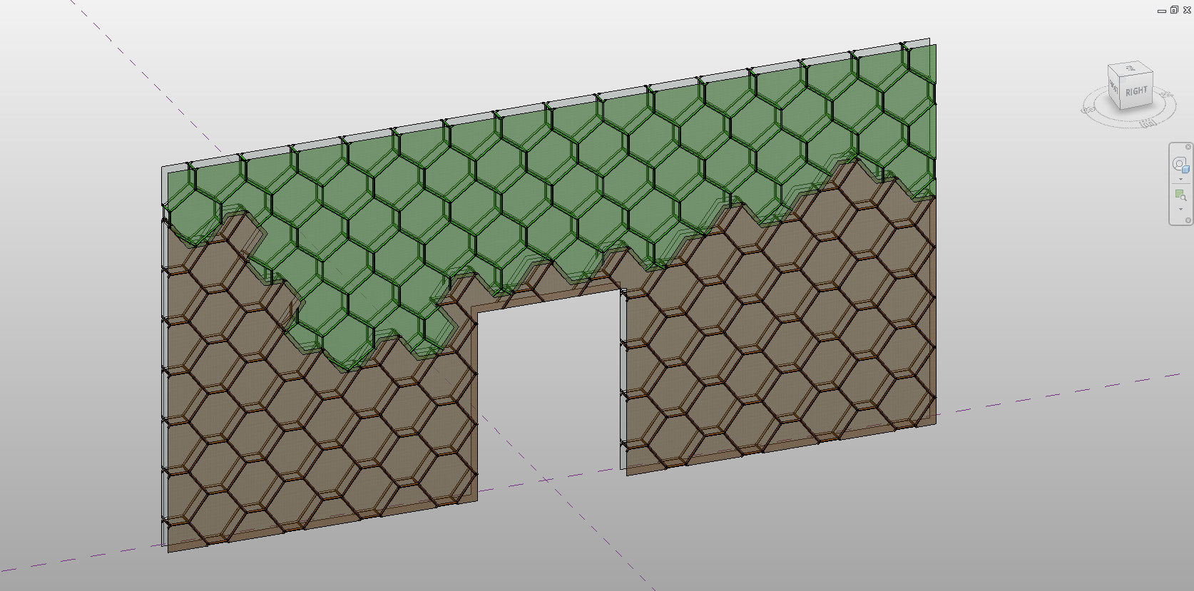

This is how I'd like to colour that wall pattern I created: along a dividing line that follows the pattern. And obviously just the mesh fron of the curtain wall.
Tue, Jan 10, 2017 at 1:21:26 PM | Colouring of Generic Model Patern Based Wall
You would have to split the wall along that line and add a different model material on each side.

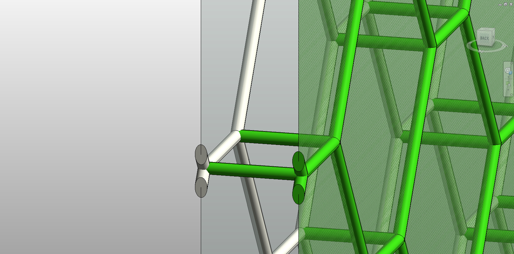

Hi WWHub, thanks for the reply. I did that - that was my first initial though - but the problem is that the pattern is breaking up.
I can't fit them... any thoughts?

I also found out that the reason why my pattern breaks up because I cut the original wall in two parts along that line so these are functioning as two induvidual wall above each other and both calculates their pattern from a different point. Is there a way I could solve this problem?

i dont know if i got your question right but if you need to separate 2 part with 2 different colors , you can make 2 types of the curtain panel each with a different material and assign each type on the designated area of the wall , but you will be constained with the spacings of the panels

Did you try to copy & paste to same location (duplicate), and edit the boundary to have 2 complementary walls. Then override the graphics of the 2 walls?
