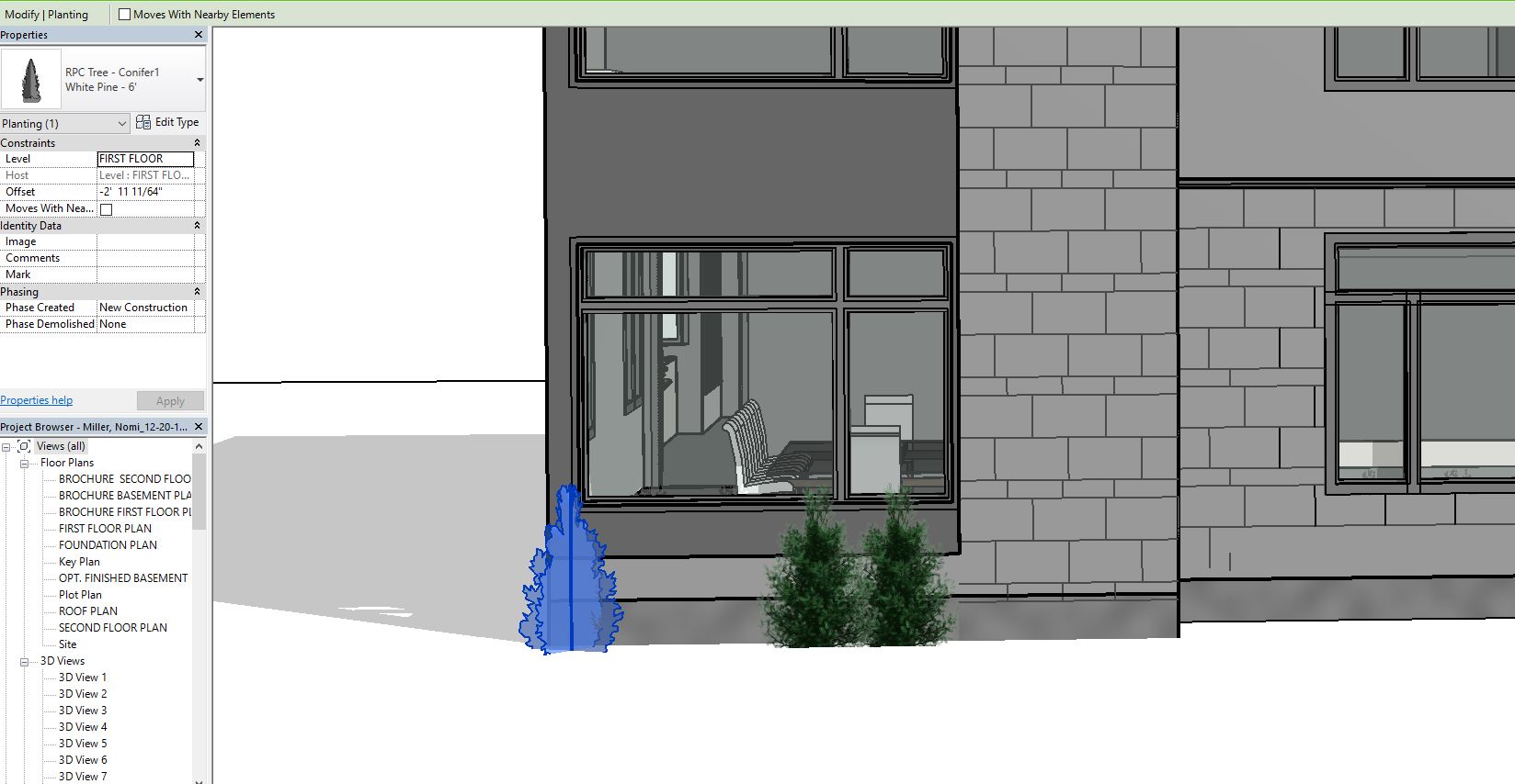

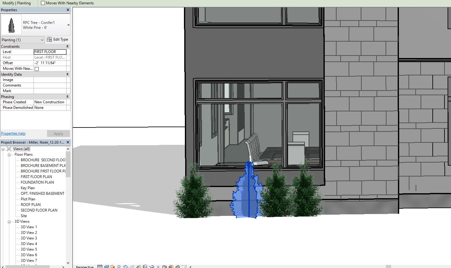

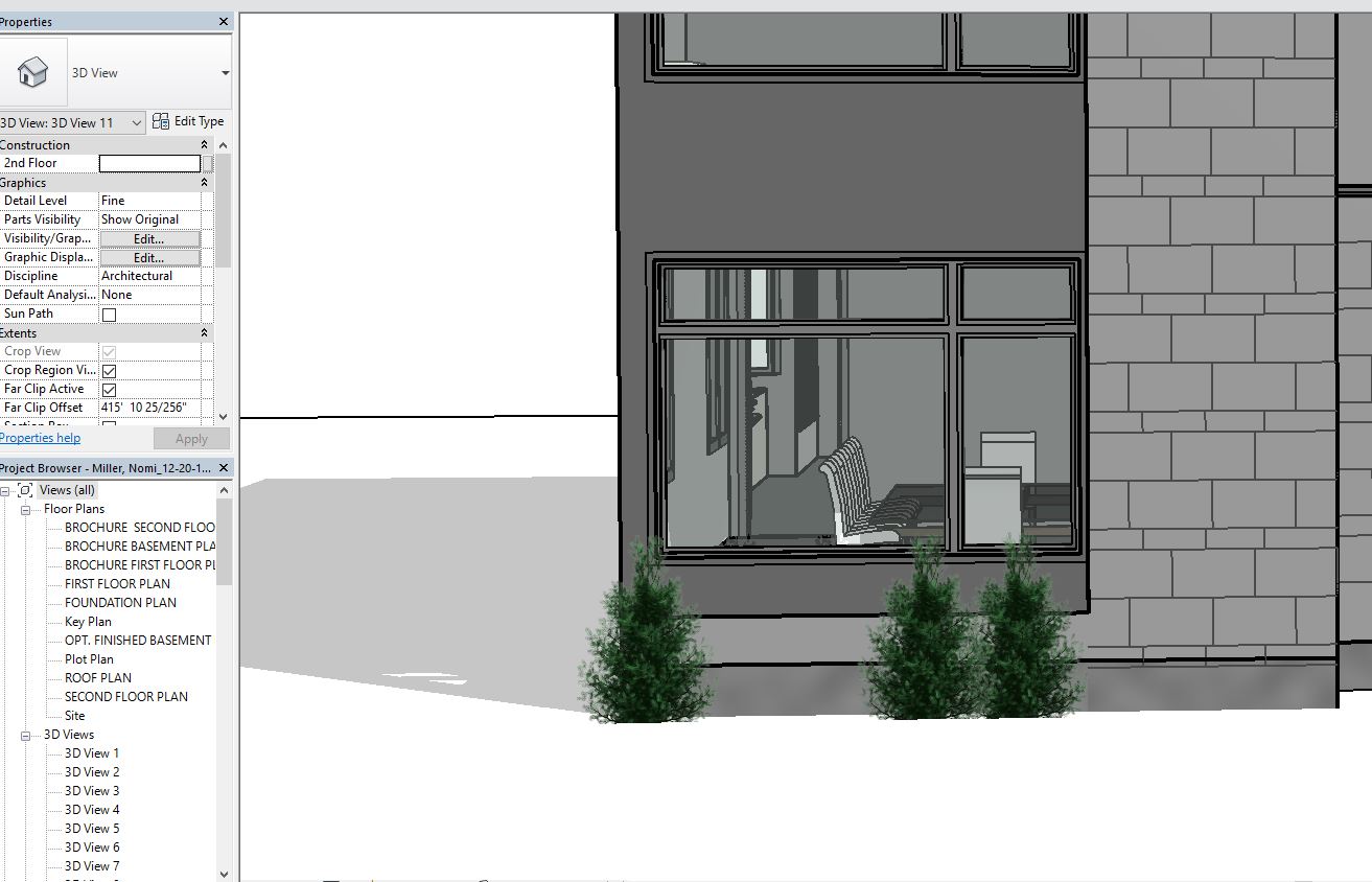

I'm pretty new to Revit and have come across a weird issue.  I have multiple instances of the same compenent (a bush) in my drawing but for some reason only 3 of them are showing up in my 3d views.  The others are still there and I can select them, they are just "ghosts" though.  I'm sure it's something simple I'm missing but any thoughts?  Attached are a few screen shots...thanks in advance!

Thaks for the suggestion!  New view didn't help though.  I did notice that it only happens when the view is set to "realistic".  When it's just shaded or anything else I see all the bushes.  Any other thoughts?

Typically, we have to trust you in your questions but over the years, I have learned that users don't always tell us everything
We don't know if these are stock bushes or someone's family.
We don't know how you placed these.  Did you copy them around or place multiple instances all at the same time.
My first thought without seeing the file is they are really not the same family.  Copy one of the ones that works and place it near these.   Did that work?  The realistic image is a 2D representation.
