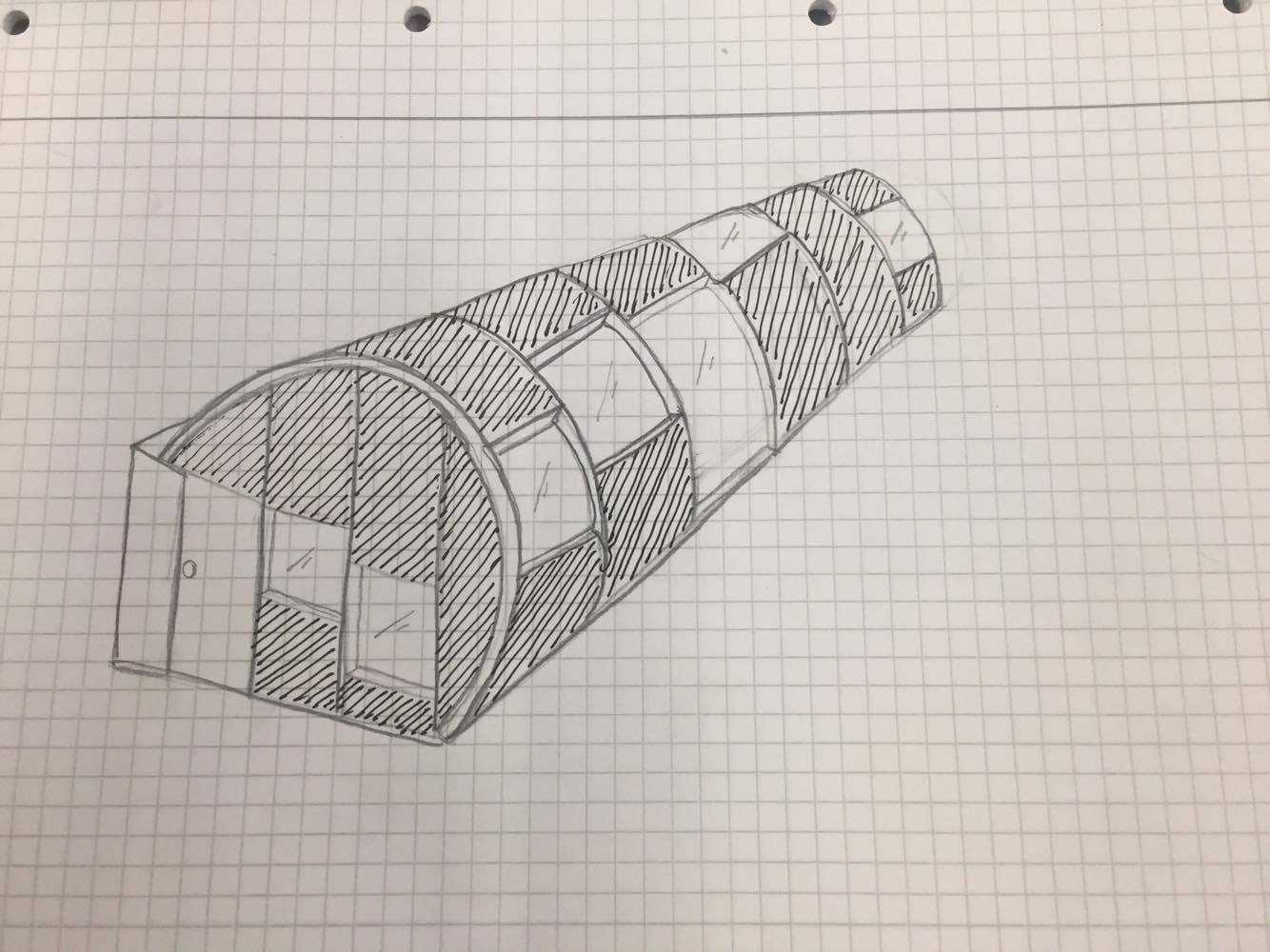

I am building af house in the form of a cylender. But I cannot seem to make Revit make curved windows. Anyone who knows how this would be done? Or that can lead me in the right direction? See drawn picture for model.

To create that building to quickest, I would do the following:1) Draw floor in plan.2) Draw a reference plane where one of the circular frames sits and then draw the frame using an in-place family shape. You extrude a shape or draw a profile and make it follow a sweep ( depending on the profile shape of your frame)3) Copy that Circular frame, wherever you want that frames spaced out to be.4) On the (2) reference plance, extrude glass along a given profile to achieve the specific pane. Adjust length to sit between frame. Copy to the same place and change to solid and change the profile to cover the areas not covered in glass.5) Copy (4) to the next circular frame and edit the profiles to suit the required profile and repeat to the end of the cyclinder.6) Draw vertical walls at the ends of the tube / or place vertical steel members if that is what you need.7) Add doors to the end walls.Shadey Add vertical wall to the long side where yoi show it running behind the sketch.9) Add a small roof in plan between (Shadey and the curved face of the circular frame/panel.I hope this helps.
