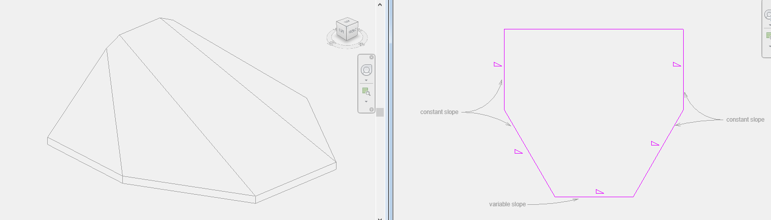

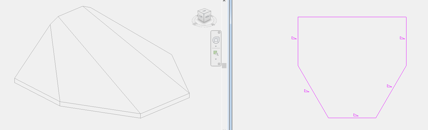

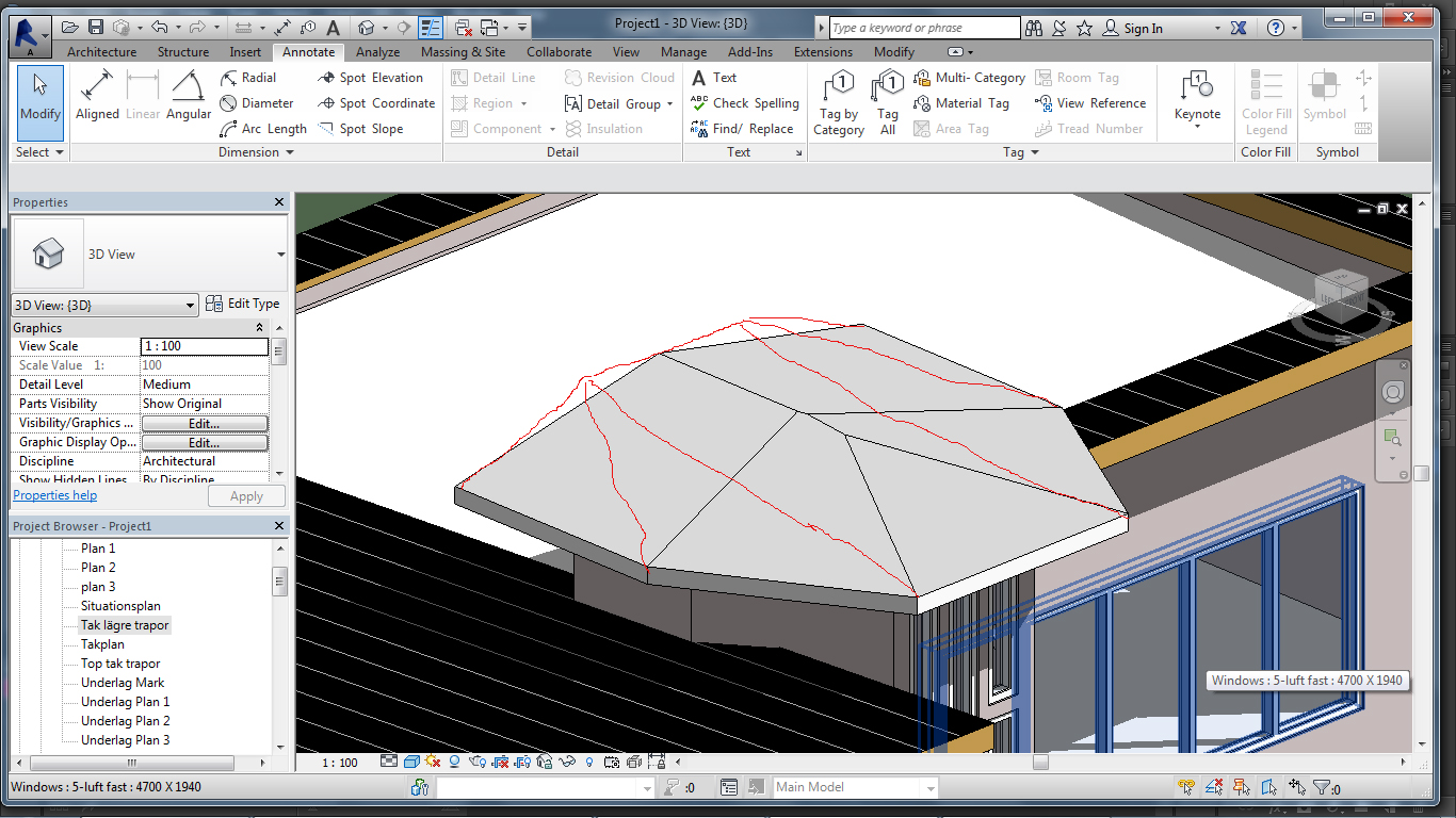

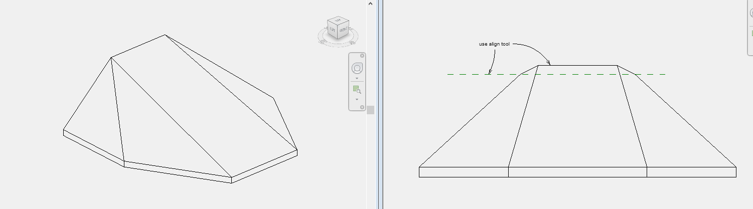

I try to make a roof and I cant manage to make it like I want.
I include few photos like Revit make the roof and with red lines what I would like to make it.
The lines 1,2,3,4 I have put them only to help you understand better what I want to make.
Can anybody help me or ask me if something is not very clear?
Thank you and have a happy new year.
Edited on: Fri, Dec 30, 2016 at 5:28:28 PM
152225_With_red_lines_what_I_want_to_do..jpg152225_This_like_the_roof_SHOULD_like_if_watched_from_the_front..jpg152225_The_roof_like_it_comes_out.jpg152225_I_have_put_the_lines_1234_only_to_help_you_understand_what_I_want_to_do.jpg
Fri, Dec 30, 2016 at 10:44:08 PM | I have difficulty to make a roof like I want.
pijpiwo
pijpiwo Avatar
Joined: Fri, Sep 3, 2010
0 Posts
5 Stars: 25 Votes
Start with the shape as on pic 1. Set your constant slope as desired. Don’t worry about the variable slope, just make sure you get the flat ridge at the top, exactly as per pic 1. In the elevation view, use align tool to adjust the height as per pic 2.
