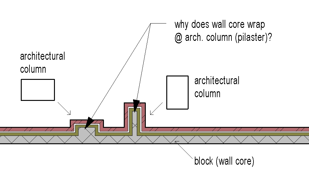

Hi,
Revit(2015) seems to wrap material around architectural pilaster incorrectly. It is wrapping the core material too. Am I doing something wrong here? Please advice
Edited on: Thu, Dec 22, 2016 at 8:47:59 AM
Thu, Dec 22, 2016 at 9:09:19 AM | Pilaster(non-structural) material wrap incorrectly-Help
Arch columns are really like pilasters and will always look like you show.  The core is always expanded and the finishes wrap beacuse the column takes on the properties of the wall.
