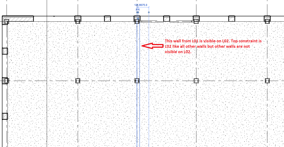

Hi! On my Level 2 plan I see the lines of some walls from Level 1. There are many walls on L01 and all have same properties and top constraint is Level 2, but only some of those walls are visible on Level 2. I don't want L01 walls to show up on L02. What can be the reason only some walls are visible on level above while others are not? Thanks in advance.

Check these:1- Cut section through wall and check it is not high enough to be seen. Check your offending plans view depth settings as well.
2- In the offending plan, check that the plan below is not turned on in Underlay on the Properties box.
3- In the offending plan, make sure the floor is turned on and its visibility isn't overridden to transparent.
4- Is the offending wall/s top height set correctly.
5- Is it actually a wall and not 2d lines or a fill region.
6- Is there a plan region that is allowing the walls below to be shown due a particular view depth applied to a specific area. It may be hidden. So turn on your light globe to check.
There are more, but these are the most obvious ones. good luck!

Thank you for suggestions. I found one solution - I did a section as you suggested and then attached the top of the wall to the slab and it worked just fine. So now I dont see walls of L01 on my L02 view.
