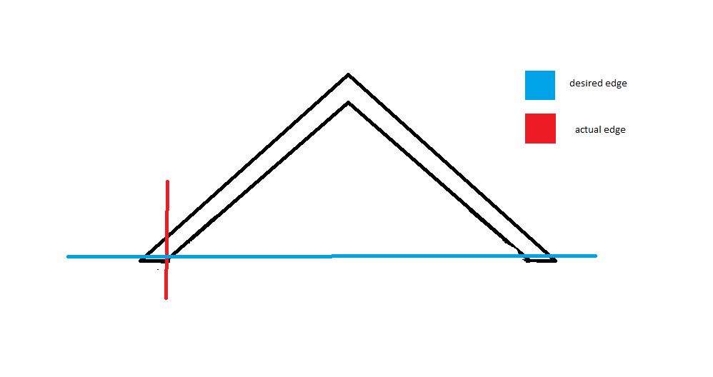

so at the bottom of the roof it cuts off vertical, i want it to cut off horizontal.
hope you guys understand.
i'll include some visuals.

For rafter cut use Two Cut_Square or Two Cut-Plumb with fascia depth set to 0.
