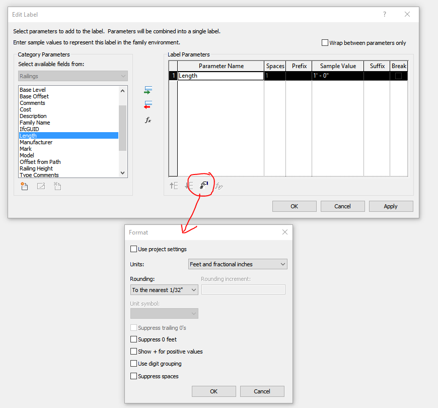

Is there a way to make the units in a length tag different than the rest of the file?  The file in feet and inches and I want the length tag to be just feet.  Any idea how to do that?

In the tag family, open edit label window and click on the edit unit parameter icon (see picture).

Perfect.  I never noticed that was there before.  Thanks.
