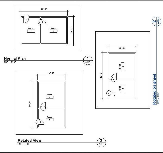

Thu, Dec 8, 2016 at 6:55:19 AM | Rotating 3D Elements all at once
#9
First question is, what are you really trying to do - not your process?
Did you know that you can rotate a view?
  1. First method is rotate a view on a sheet.  Everything turns on the sheet including text and title.
  2. Second method is simply rotating the view.  Turn on the crop region, select it, then rotate it.  This turns the view but all annotations remain as normal to the view.  They do not rotate with the view (except dimensions).
Look at the attached image to show the choices.
If the building needs to rotate in relationship to the site but project north remains the same, simply rotate the site!
And finally, there are the rotate north, rotate project north and yse - choose the elements and rotate them.  << I really don't think you want this last choice.
Thu, Dec 8, 2016 at 4:06:46 PM | Rotating 3D Elements all at once
#10
raja15
Joined: Mon, Feb 21, 2011
84 Posts
5 Stars: 1 Votes
Thanks for your response.
To clarify what I am trying to do, is simply rotate the 3D elements in the project. We use this procedure when we are better orientating a building in regards to its site, ie sun/breeze path etc.
Sometimes the building may only need to be rotated 10 degrees but makes a better design in the process. In some cases we have a collection of buildings which may sit side-by-side on the site, but each building has been rotated slightly to better that particular building's orientation.
I am aware of the procedures for rotating a view on a sheet, rotating the crop region, and rotating the site, however neither of these solve my problem. As rotating the crop view applies to that view only, rotating a view on a sheet is for soley that sheet, and rotating the site would mean the bearings entered from the Title Survey plan would be altered.
All I am really asking for is if anyone else has encountered this problem & how they resolved it. Perhaps I will just need to do some more trial&error work myself in the families I know are not working to resolve it.
Thanks everyone for all your advice and help so far.
