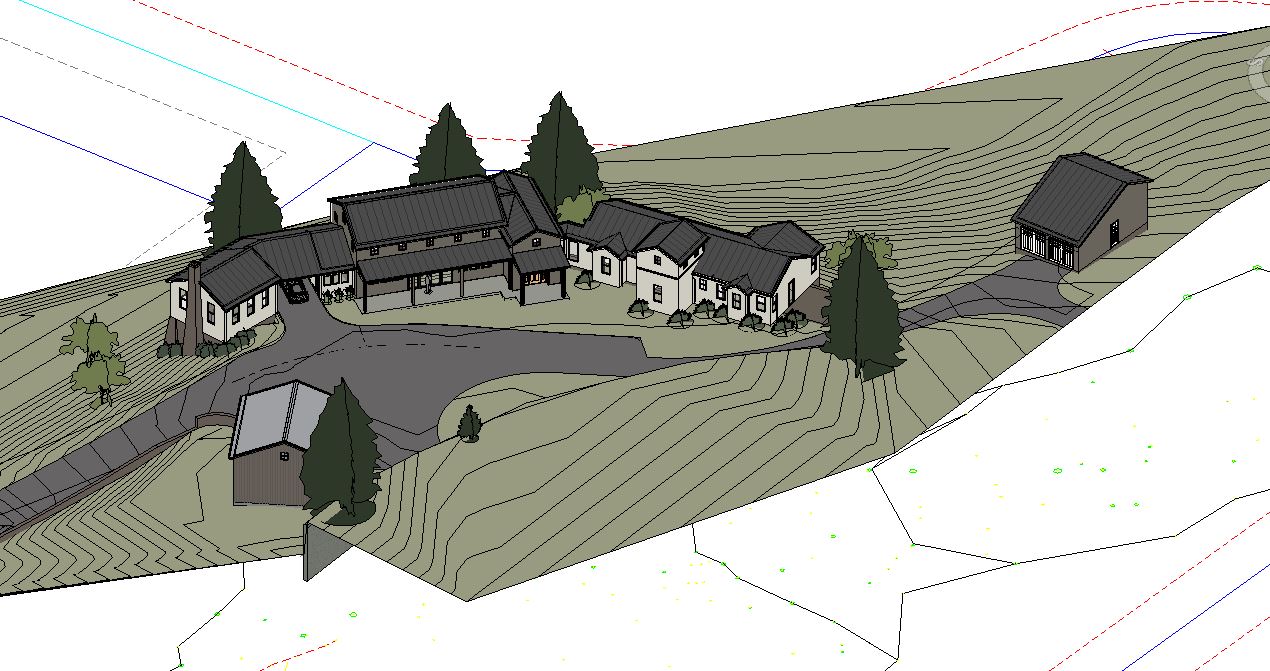

I need to rotate this builing 1.383 degress on the site to make it a round number off of north. I've heard you should 'rotate the site' instead of the building itself but I'm not sure what the 'site' is. I have imported dwgs, topography, property lines, retaining walls, and linked rvt buildings associated with the site. So rotating all that seems difficult.
As I am writing this it seems I should create a project with just the building and link it into the file with the site components as I have with the other buildings. Working on that now...

We also do landscape model as a link. But you also have cad drawings (links) to rotate inside Revit. A bit of work...

Have you used "rotate project"?
