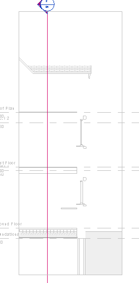

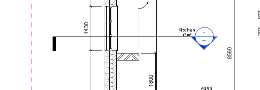

WW Please find attached.
As you can see in the images there should be a wall above and below the window.

OK... I see a wall below so probably not VG but it could be phases even though you say you are not using them.   Just a click away.
Could this wall be on a different workset that is off?
Always list what Revit and Updates you have installed.    There are issues that are associated with releases although I don't know of any like this.

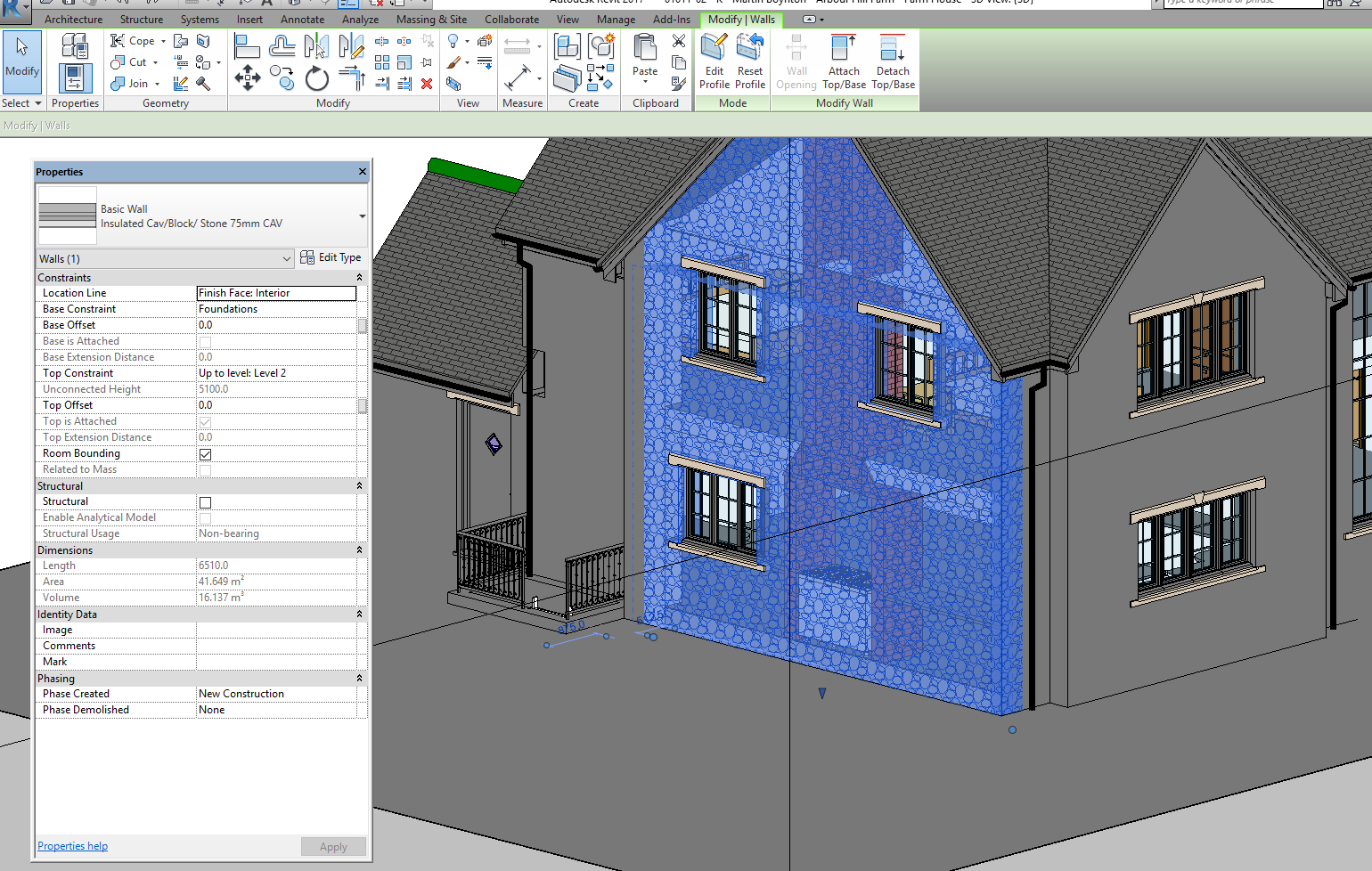

Post a little 3D image and the properties of the wall.  The wall is continuous, there is not a seperate little wall under the window, correct?

WW, please find attached, you are correct it is just one wall.
