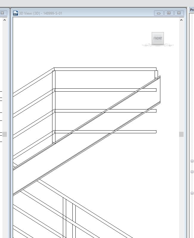

Hello all,
I am using '15 and I am having trouble with a handrail (weird, huh?). Does anyone know if there is a way to "trim" a handrail so it matches a stringer profile? I have attached a screenshot and basically I need to trim the rails at the stringer, instead of having them continue through the stringer. Any help would be much appreciated. Thanks!
Thu, Nov 3, 2016 at 1:09:06 PM | Cleaning up a handrail/ stringer join
What are you doing there?  There would be no flat handrail over the sloping stringer.
Thu, Nov 3, 2016 at 1:16:55 PM | Cleaning up a handrail/ stringer join
kellyd94
Joined: Thu, Apr 19, 2012
6 Posts
The stairs lead up to an access hatch and the handrails cannot extend above said hatch. Please see the attached image. Thank you.
Thu, Nov 3, 2016 at 1:49:39 PM | Cleaning up a handrail/ stringer join
The standard handrail will not do what you want here.   You will probably have to do something in place for that portion of the railing.

Try model in place.
You can model as you want.
Sat, Nov 26, 2016 at 1:04:26 AM | Cleaning up a handrail/ stringer join
Dheena14asian
Joined: Sat, Oct 8, 2016
0 Posts
Split the railing then remove the portion to repair.
Use model in place to create a new one ( You can apply material to it later )
