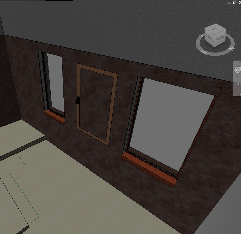

I made a 100% profile wall extrusion.
Instead, I uploaded a new window familly and it works... So... there should be a problem with the previous familiy...
In the picture attached, the "old" window is in the middle.
Edited on: Wed, Oct 26, 2016 at 10:21:50 AM
Wed, Oct 26, 2016 at 10:41:53 AM | Problem: wall's extrusion profile covers windows and doors
I guess I don't see the wall extrusion you were having problems with unless you mean the multi-colored area.   If you did an extrusion for this then I have a better solution for you.  Use a thin wall and join that wall to the other wall.   We do that all the time for wall veneers like tile and stone.
Wed, Oct 26, 2016 at 10:47:26 AM | Problem: wall's extrusion profile covers windows and doors
Check out this thread for my explanation of using this thin wall.
Wed, Oct 26, 2016 at 10:57:18 AM | Problem: wall's extrusion profile covers windows and doors
unnbe
Joined: Wed, Jan 13, 2016
0 Posts
Yes, the "multi-colored area" is the stone cladding, that is the profile extrusion.
I will learn your method, many thanks!
