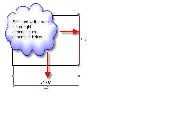

I went home to have a beer but thanks for the quick reply. Usually when I click on a wall the only length dimensions that are displayed are the ones of the walls running perpendicular to it. Do I maybe have a weird setting somewhere? So I constantly try to figure out which perpendicular wall to click on to edit a particular length and then when I change the dimension it allways shifts the wall below.

It's very simple. After you select a wall a dimension that is perpendicular to it appears. In this case the selected is red, temporary dimension is below. Adjust the temp dim and the wall will move left or right depending on the dimension. Somethimes beers will cause an error. More beers, more errors. Post edited on 2006-05-07 03:34:45
