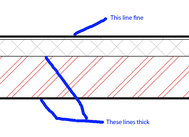

we have some problems of the line weight of multi-layer walls, the outer lines are thick and the inner lines are fine (like the definition in the object styles) is it possible to change or define the thickness of the lines for one layer in a multi-layer wall? please look also at the picture ....

Yes, under you visibility/graphics tick "cut line style" under "override host layer" click edit and assign line weight to different wall layers
