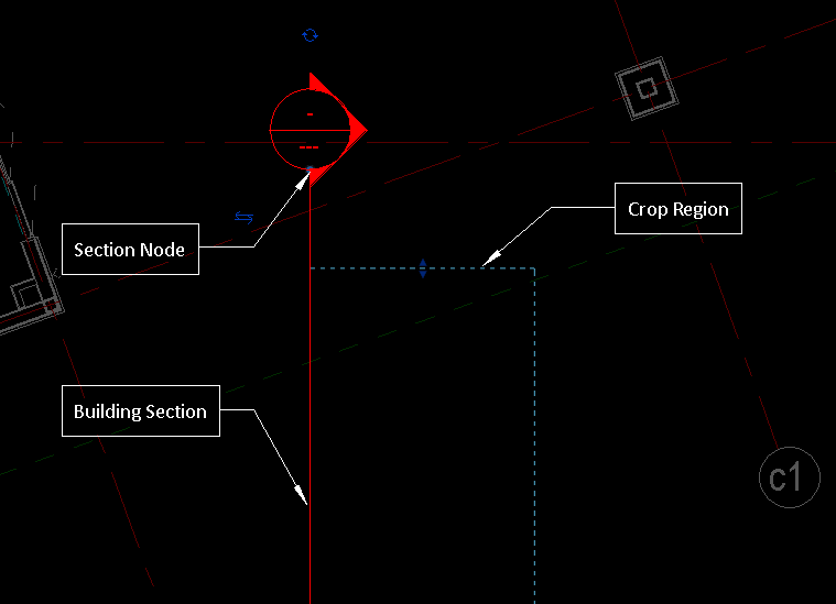

I am quite confident that others have been frustrated by this aspect of Revit 2016 or any version of revit as this has occured with all of the versions that i have worked with.
Esssentially - Is there a way to adjust the Revit Building Section (crop region) and section box at the same time in revit.
To explain this alittle more if there is confusion with my question.  When you draw a building section in plan view you have basically a couple of options to refine your section.
You can expand or collaspe the width and depth of your cut.  But when it comes to refining ones width i always have to select the section nodes(one by the section head, one by the section tail) adjust those to my desired width and then i also have to select the dashed building section and do the same with those.
Is there a way to lock or pin those elements together so the section nodes and crop region adjust at the same time? - See attached for clarity
Thanks for your help community!!!
Don
Fri, Oct 21, 2016 at 12:02:28 PM | R2016 - Revit Building Section
They both work together but only when initially placed. After that, the the head and tail are view dependent.
