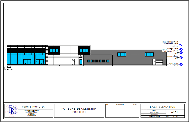

I have a problem. Im trying to print my elevations on a 11"x17". But when i place it into a title block the level text and level bubble are huge. I cant seem to find a way to scale the text or the bubble down. Attached is a printscreeen of the drawing. Can someone help me please.

i've been trying to do the same thing. Anybody know what the problem is? Thanks Post edited on 2006-04-23 22:43:30

Check the scale of your view. The elevation marks should scale to the scale of the view. You can also turn off the level annotations properties. I hope this helps - I was unable to download your attachment.

take a look at this thread http://www.revitcity.com/forums.php?action=viewthread&thread_id=3790 Post edited on 2006-04-24 14:43:55
