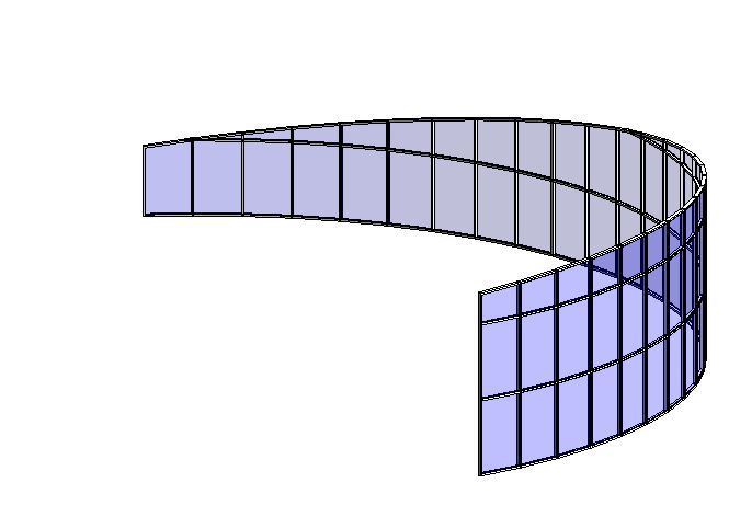

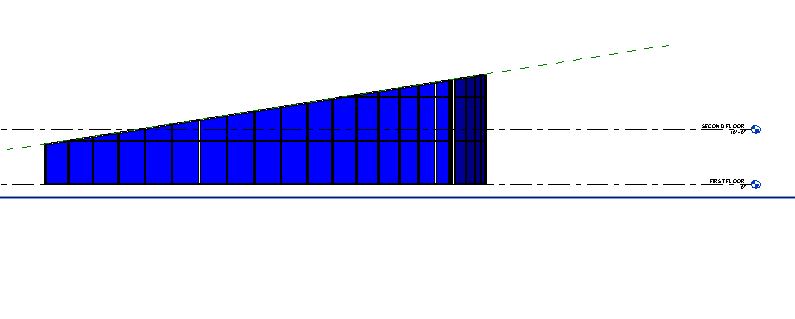

Thu, Nov 6, 2014 at 6:14:18 AM | CURVED WALLS AND CHANGING THE PROFILE
Rachit
Joined: Mon, Apr 9, 2012
7 Posts
3 Stars: 2 Votes
It indeed is a great technique by Mr. Spot. I have managed to edit the curved walls under the sloping roof. Going further in developing the model I needed to have a few curtain curved curtain walls also that are terminating under the sloping roof. I've tried working on the same principle but it doesn't work. I would like to know a way around the same. Thanks P.S. Any way we could tag Mr. Spot in this conversation for us all to have his input too.
Thu, Nov 6, 2014 at 7:58:51 AM | CURVED WALLS AND CHANGING THE PROFILE
You can attach the top of a curtain wall to a reference plane.
