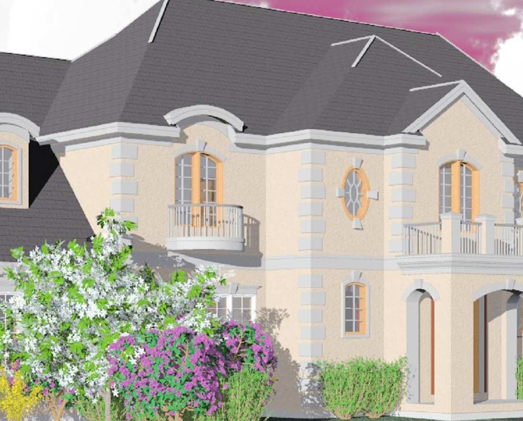

Does anybody know how to draw keystones that are fixed to the corner/edge of buildings??

If you are referring to Quoins, i use solid extrusions and copy them up the corners. they are not wall hosted so they can 'float' if you don't double check the alignments from both viewing angles. Frieze boards i use solid sweeps and band boards i use wall sweeps similar to corner boards. Keys are face hosted components. see attached for a variety of these.

The dwf doesn't seem to work. here's a jpeg

Probably the best way would be to make a column with the Quoins that you can place at any corner. In this example every bump out at the corners is a column with the materials, sweep and everything already included int he column family. If the attached family doesn't work, send me an email addy and I'll send you the column .rfa for you to play with. Example: http://gibsonhouse.dyndns.org/famfoto/main.php?g2_view=core%3ADownloadItem&g2_itemId=350
