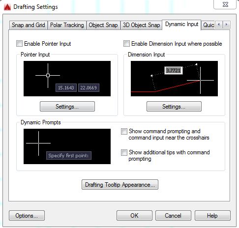

I had this problem too when I converted from Autocad 2013 to 16. There are several things you should do.
First, turn off 'hardware acceleration'
Second, go to Object snap settings window and disable any tracking stuff. I attached a screenshot.
Third, check this link   ( https://knowledge.autodesk.com/support/autocad/troubleshooting/caas/sfdcarticles/sfdcarticles/Cursor-is-slow-or-jerky-in-AutoCAD.html)    and apply these commands:
SELECTIONCYCLING = 0UCSDETECT = 0ORTHOMODE = 0DYNMODE = 0ROLLOVERTIPS = 0SAVEFIDELITY = 0QPMODE = 0SNAPMODE = 0SELECTIONPREVIEW = 0PROPERTYPREVIEW = 0
I hope these will solve your problem..

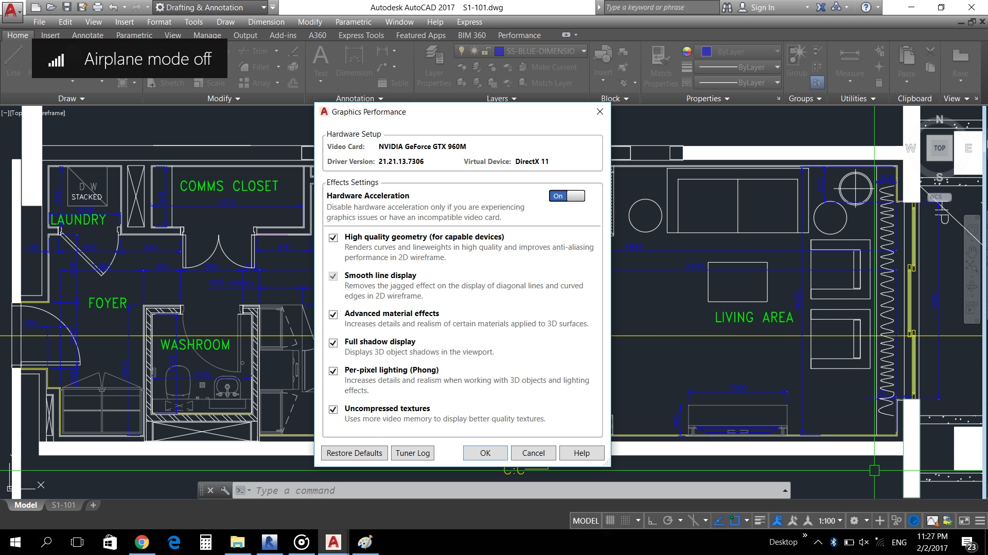

Fri, Feb 3, 2017 at 9:02:54 AM | Cursor lagging
Dheena14asian
Joined: Sat, Oct 8, 2016
0 Posts
Thank you yigitti, JustinDaffara & Beaucoupnice
I have tuned on all the settings in Graphic performance.
Now it is better.
Thank you all.
