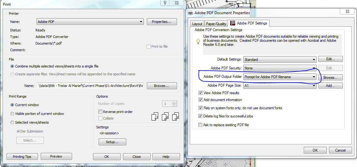

i use a software called renamer lite to get the exact name i want , before exporting i set the setting in adobe printer properities to prompt for Adobe PDF Filename .... and this skip the option to rename each sheet before exporting it and then after finishing i use that software to delete everything in the PDF names and leave only the sheet number

Yea, that is where I am at now. I was just seeing if there was an option or something you could check so you wouldnt have to delete everything around the sheet number, just so I could print off likq 100 spools, and just hold the enter button something. Eh I guess Revit wont let you be that lazy... RATS!.. lol
