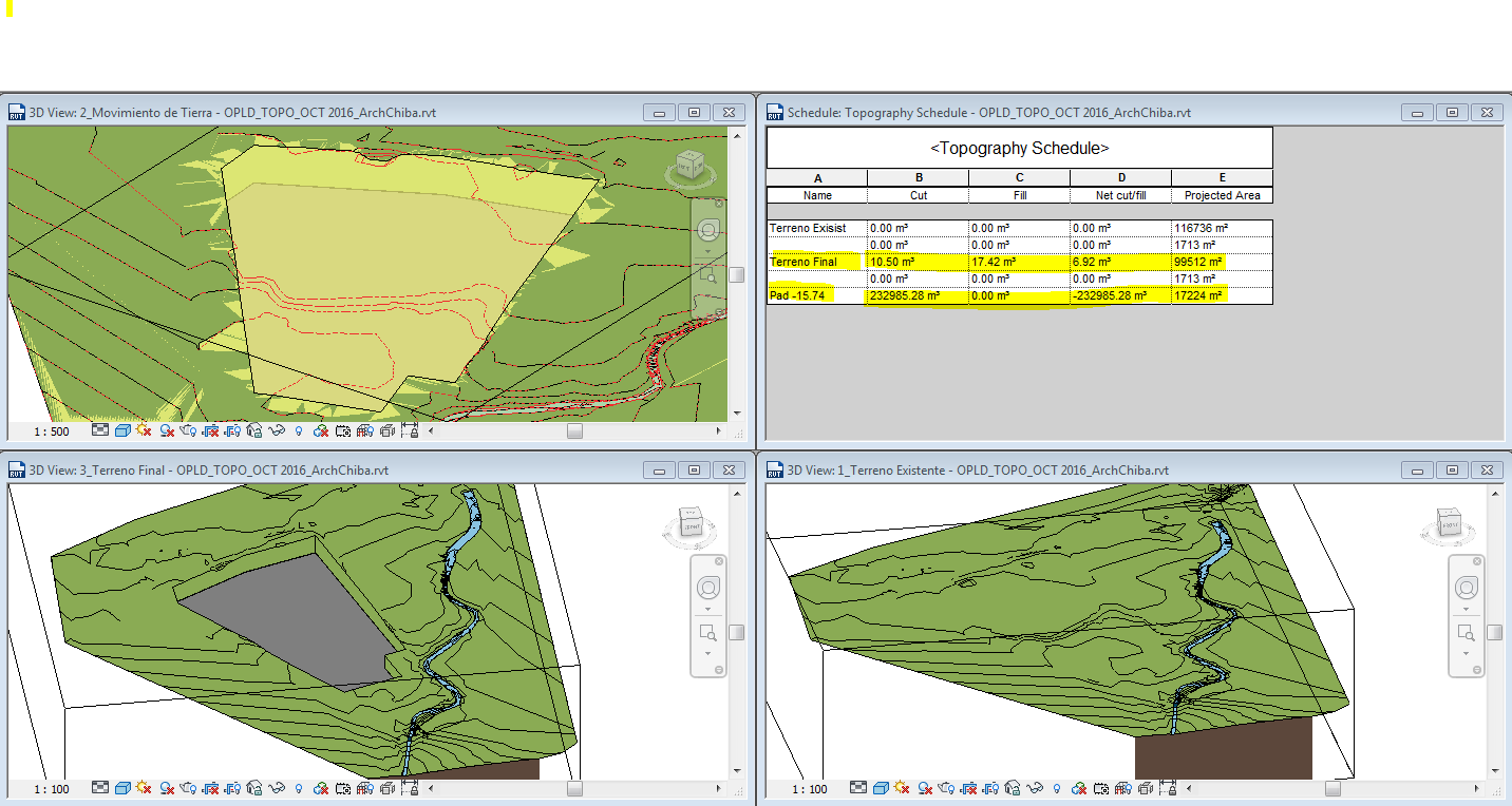

I´ve done a Graded Region, created Building Pads and a Schedule.
I don´t understand the correlation between the data between the CUT/FILL for (Terreno Final) and that of (Pad -15.74).  Should they not be the same ?
Please find the attachment below.
Thanking you for your help.

What?   No way would they be equal.   The total of the pad sf & your final sf = the exist sf.

Thnks for getting back to me WWHub.
I thought that (Pad cut)m3 = (Final TS cut)m3...
According to your equation (The total of the pad sf & your final sf = the exist sf.) , in the image i attached the figures don´t add up.
I donno what´s going on :S
Tue, Oct 4, 2016 at 12:51:07 PM | Toposurfaces, Graded Regions, Fill/Cut and Schedules
My math say 99512 + 17224 does = 116736.
